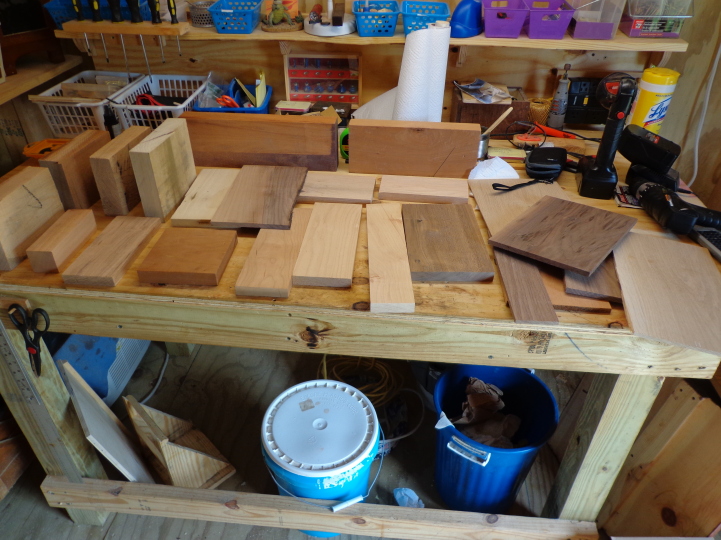

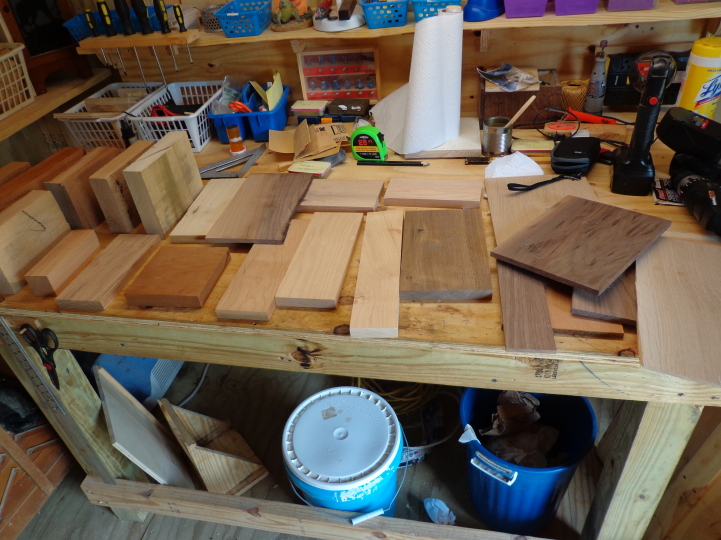

ning-dsc00132-14076-62.jpg?width=721here is a pix of wood that i got ning-dsc00131-14076-4.jpg?width=721
