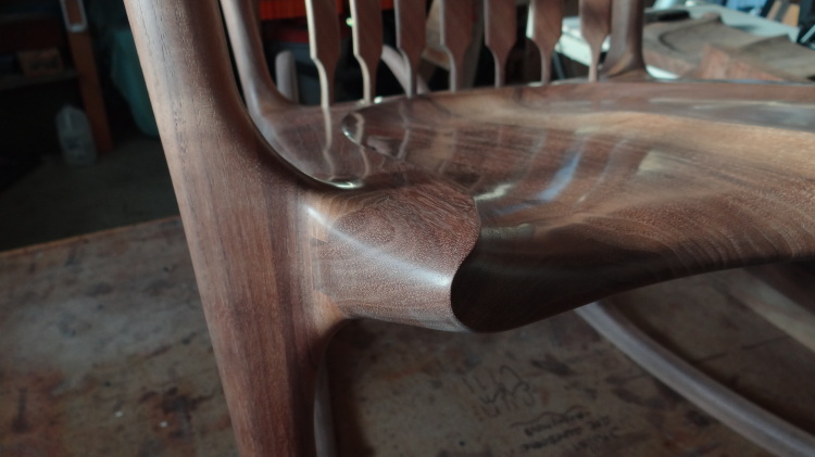

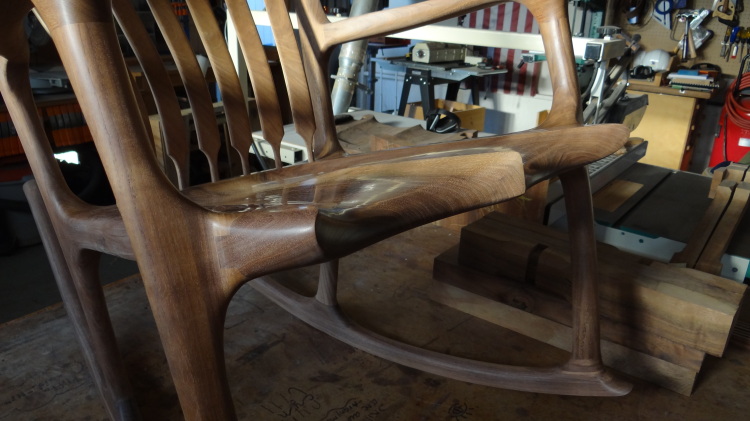

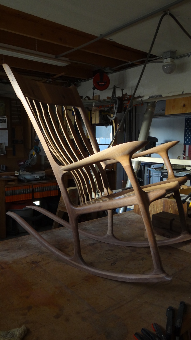

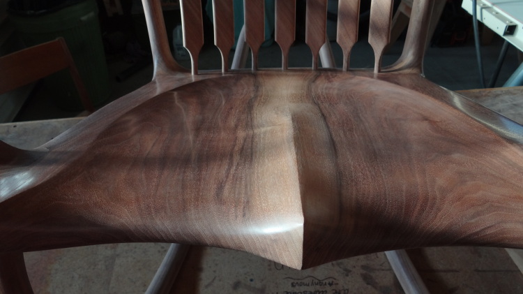

You'll see in the following pictures how close to finish the chair looks using the sanding techniques we use. It's amazing to see the grain pop before any finish even touches the chair, you can imagine how the colors of the walnut are going to just come alive. But for now, I still have the legs, the rockers, and the underarms to finish sand.
I sand through the grits from 80 for roughing out the final lines, all the way up through 800 then the final burnish with Abralon 1000 grit pad on my ROS. The burnishing is actually taking effect around the 500 grit time, but the gloss you see happens at the Abralon stage.
I love this part of the chair making process, going over the entire chair with an ROS and Abralon and watching the wood come alive, it is just pure joy in the building stage.
ning-walnutrocker7-14021-99.jpg?width=75ning-walnutrocker9-14021-82.jpg?width=75ning-walnutrocker8-14021-9.jpg?width=750
ning-walnutrocker-14021-99.jpg?width=750
Thanks for looking folks, as I said the under arms are not done yet as the rockers and lower legs are not finished, they still need the 800 then the Abralon. I can't wait to get the wipe on oil finish on, it's going to look very cool I think.
