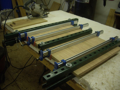

May 6, 201313 yr comment_13806 John, A friend of mine who does a ton of intricate and, sometimes large, marquetry projects uses a mechanical press. Here's a link to a pic of his press. My system is a little less elegant. I use UniStrut. In this picture, I'm not using the UniStrut as a press, but you get the idea. After their use to keep the panel glue up even, I use them to press the panels together face to face, much like a veneer press with reeeely thick veneer.  I plan to use them as a true veneer press in the near future. When I do, I'll use a true 1" thick MDF ballast on both sides of the panel.  Gene'The true soldier fights not because he hates what is in front of him, but because he loves what is behind him.' G. K. Chesterton Report
