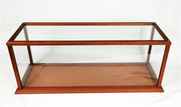

John, due to the size it will be either on a table or shelf. The only description they really gave me is a glass or plexiglass dispaly case but nothing fancy. What stumps me is how to create a frame for the glass top . Probably something along this line
ning-52603-13792-1.jpg?width=721

You could make a wooden base then build the sides and top from 1/4" plexiglass. The plexi could be glued together on all edges as well as the top glued onto the sides. The plexi "box" could set into a dado around the wooden base.
This method allows an unobstructed view of the interior because the plexi solvent causes the edges to become clear. It's very strong yet light. Unfortunately, it isn't cheap.
Lew Kauffman-
Wood Turners Forum Host
Suggestion: Put life and action into it, don't set it flat. Make  lie in the case on a rakish angle as if it is grading on a slope.
You can do the wood frame a couple of ways.
The easiest is to do a faux frame. That is glue the glass together like an aquarium and apply the wood framing to that.  Use the framing to reinforce the glass joints.
This is easier than trying to create a thin frame with structure.
If you prefer to do the  frame as a stand alone  rigid structure into which the glass sets,  consider a finger joint router bit to assemble the Horizontal pieces of the top.  You can route a slot in all the pieces to lock the glass in much like one makes a raised panel door.
For the 4 vertical members:  inset the  them  into  and through the base.
Do it like you were making a stool and use a wedge from the bottom to lock the 4 posts tightly in place.  This will give you structural rigidity. The  frame for the top with the glass can rest on little  mortise and tenons or simply dowels to locate it.
I'd turn the ends entering the base. The shoulder of the 4 vertical posts will cover the hole in the base and the round tenon will allow you to rotate them to precisely  locate the angle.
