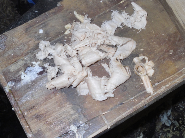

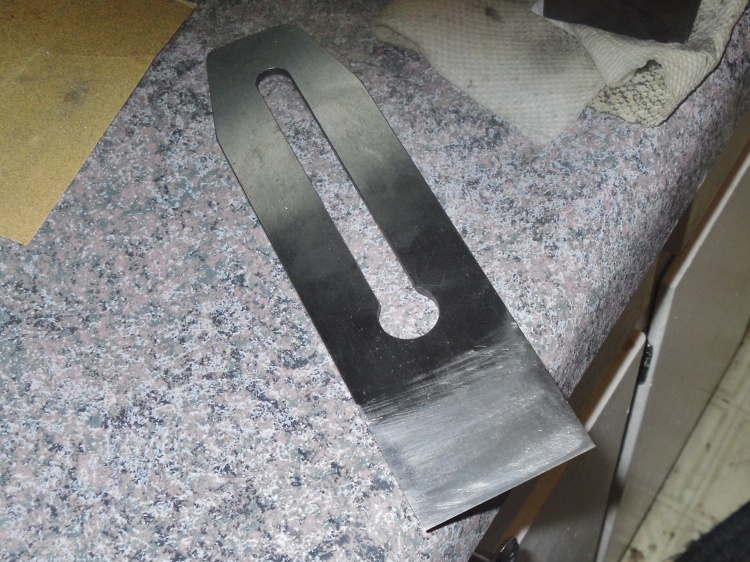

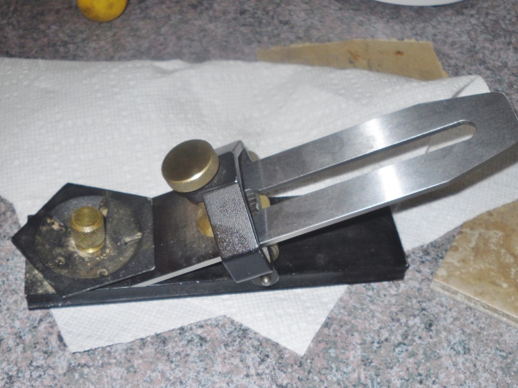

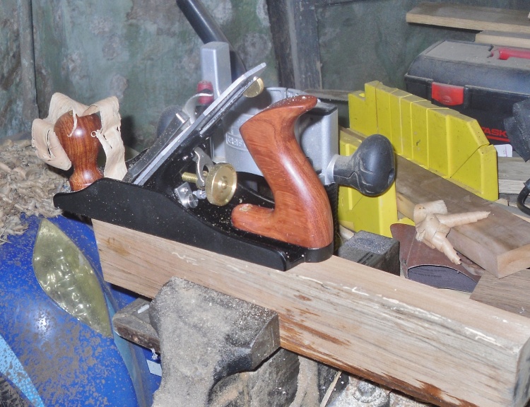

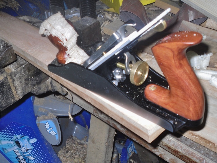

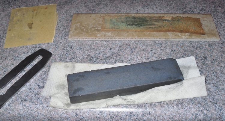

May 11, 201313 yr comment_13595  Ok.  Worked on the back of the iron.  Was a little hollow back there, now flat.   Polished up, too. Did a little shapening on the iron.  Set up to match it's 25 degree bevelVeritas Mk I guide system.   Oh as for the backUsed a few of my "tools" on itA little 150 Grit paper, a two sided oilstone, a ceramic tile, and an old leather belt with some Green stuff on it.   Ok iron is sharp.   Checked on the chip breaker.   Few burrs on it, so a quick pass or to, just to smooth it out.   Where the frog meets the flat area at the mouth:  There is some milling marks in there, looks like scallops. Not all the way across, though.   Milling to get the mouth done?? Had to set the frog back a bit.   Frog was also at an angle to the mouth,   Loosened the one frog bolt and then adjusted the middle screw until frog was square to the opening. Handle bolts:  Two of the three were a tad loose, but tightened right up.   Handles are comfy, and quite solid feeling.  This is one HEAVY #4!   And LOOOONNNGG, too.    A full inch longer than my Millers Falls planes. Got everything back together, for a test drive on the Black Cherry scrapFiddled around with it, until it started to cut, adjusted the lateral to take a wide shaving.  Good thing this is for thin shaving work.  Almost out of threads for the wheel to use.  As for them shavingsGetting there. As for the Maple test trackWith everything tightened up, checked the sole for flat:   Wasn't too bad.  Barely any light under the straightedge.   Toe and heel were a bit up.    Will check again next time everything is out of the plane.  Sides are square, and saw NO LIGHT under the straightedge when going across the sole. So far?   Me LIKEY!   Bedrock frogs take a bit of learning to get them just right,  one of these days I will llearn how... Planer? I'm the 'planer', and these are what I use... Report

May 12, 201313 yr comment_13599 Looks good Steve. How far back do you have the chip breaker from the edge of the blade?Good, Better, Best never let it restTill your Good is Better and your Better is Best. Report
May 12, 201313 yr Author comment_13598 Usually I set mine about 1-2mm back. Just so a shiny line is showing. At least that is where I keep the Milers Falls ones at.Planer? I'm the 'planer', and these are what I use... Report
May 12, 201313 yr comment_13597 That's about where i set mine too.Good, Better, Best never let it restTill your Good is Better and your Better is Best. Report
May 12, 201313 yr Author comment_13596 This plane is proving to be a bit "fussy".     A little here, or there, and the shavings change big time.  Tomorrow I take another looksee at it.   Frog may have to move a bit, iron might need a look at.   Shouldn't have the adjuster wheel all the way out like that.   Still making very nice shavings, jus could be better.  It is about the same shavings as my M-F #9 sends out.Planer? I'm the 'planer', and these are what I use... Report
