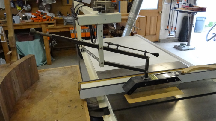

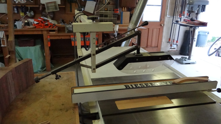

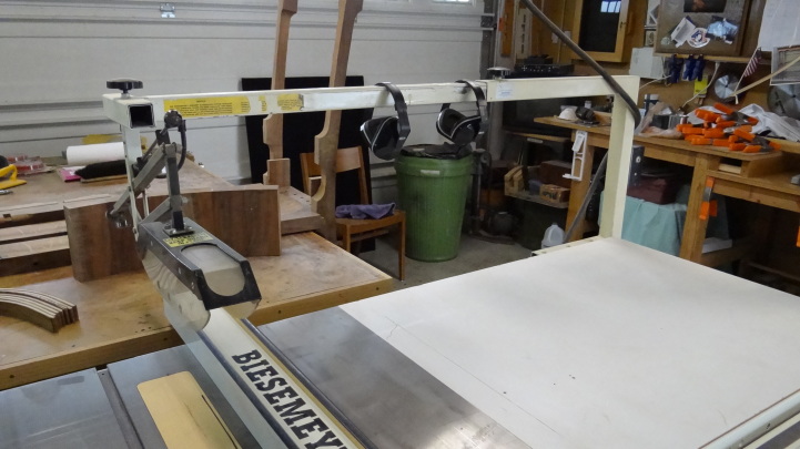

May 18, 201313 yr comment_13533 John, here is a pic of mine, I shot a video too but it came out like crud, I'll try again tomorrow afternoon. This is Biesmeyers early model over arm. As you can see it is cantilevered and it lifts up out of the way in a second. The complete arm assembly slide to the right if you need to completely remove it from the area. The suction from the dust collection to the cabinet under the saw seems to be sufficient to pull the dust down through even that zero clearance insert I made. I did not even take my own advice mentioned above to drill holes in the zero clearance, and it still suck the dust down through the insert. John MorrisThe Patriot WoodworkerProud Supporter of Homes For Our Troops and Wounded Warriors Project Report
