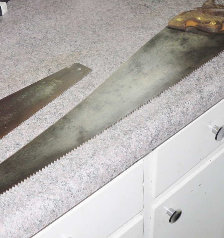

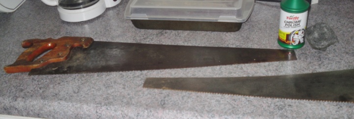

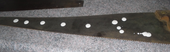

Tried a bottle of turtle wax chrome polish on a couple saws today.    Scrubbed them with some 0000 steel wool  ning-sdc15160-13408-82.jpg?width=721The before shotning-sdc15162-13408-49.jpg?width=721Just a dab will do you ( where have I heard THAT before???)  andning-sdc15163-13408-47.jpg?width=721The after.  Used a paper towel to wipe off the mess.     Will try the foil ball in a few days....
