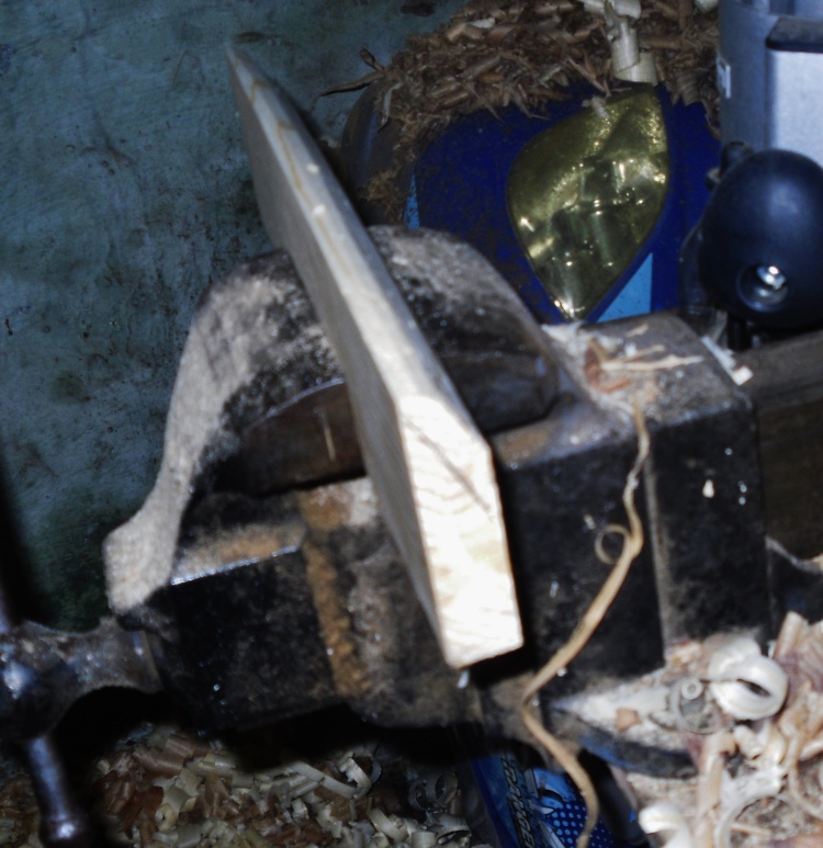

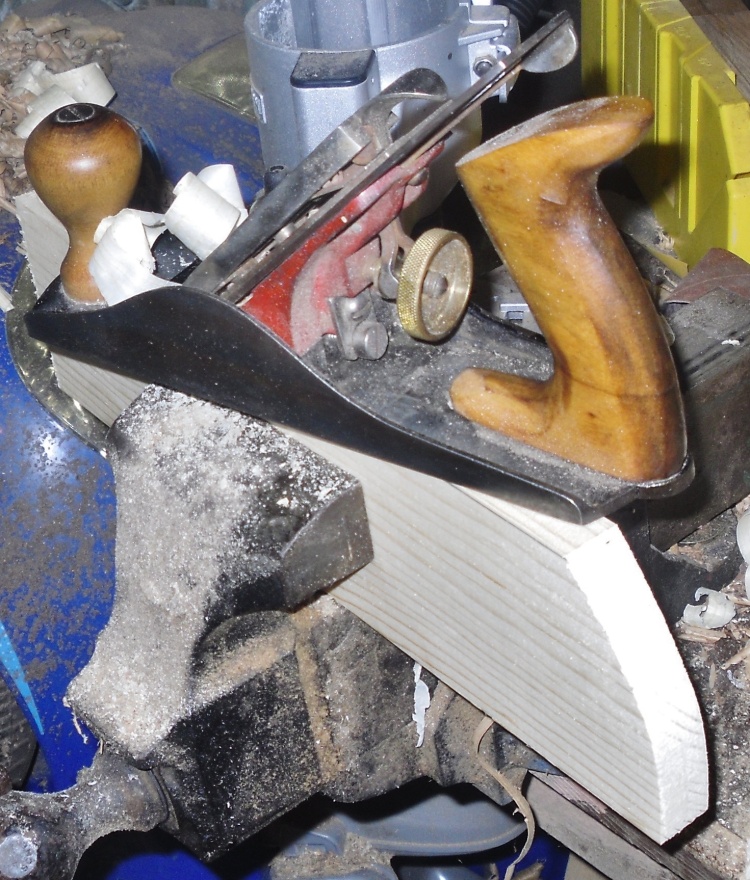

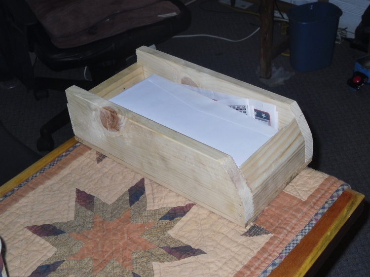

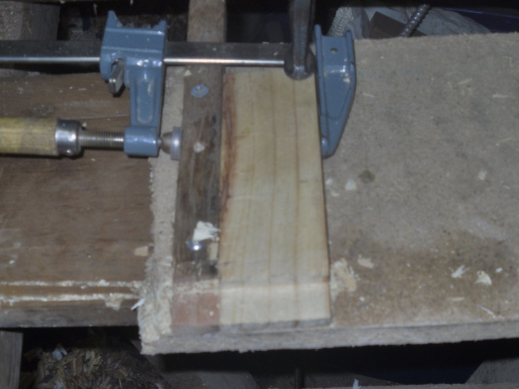

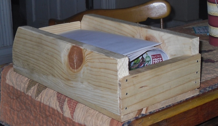

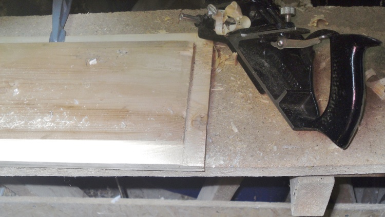

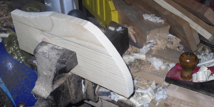

May 23, 201313 yr comment_13186  Seems that when the mail shows up, it gets dumped onto the dining room table.   Needed SOMETHING as a mail catch-all tray.   Had some scraps left from the Hutch build, soTook a cambered Jack plane to the "sides" to get down to that there pencil line.  The Corsair C-5 with the Schwarz-style 8" camber made short work of this.  Then a trim to match the two sidesThen other parts saw my Wards #78like the bottom of the tray.   The back piece had rebates on both endsas for the other end, it had to match a curved side. so block planes to cut the curveTook awhile, and the piece was longer than I needed, enough that I could get a second piece, IF the first one went "bad" ( Not that I make mistakes, of course)  Trim to fit, some nail and glue ( after getting the old dried out plug out of the bottle's nozzle) andTodays mail box, or is it a "Letterbox"?Just nailed and glued up.  Nothing "Fancy".   Still debating about this end, round over, or leave as is??? Cost?   ZERO    Fun?   Loads.  Planer? I'm the 'planer', and these are what I use... Report
May 23, 201313 yr comment_13192 Cool! Looks like it will fill the bill perfectly!Lew Kauffman-Wood Turners Forum HostTime traveler. Purveyor of the world's finest custom rolling pins! Report
May 23, 201313 yr Author comment_13191 And tends to hold too many bills, as well.  Maybe I need a second one, and mark them as "IN" and OUT ???Planer? I'm the 'planer', and these are what I use... Report
