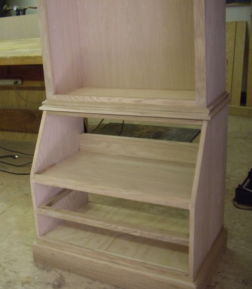

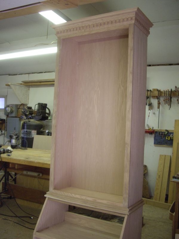

Here are two pics of the unfinished case. Doors and drawer fronts are made. There will be a drop down door with lexan over the slanted part of the base. Two drawers go under it.
Gene
Gene, it's absolutely beautiful! Very nice work sir!!!!! And I am sure sorry about your wifes fall! Not good!!!
Is the case ply or solid wood?
John,
Thanks for the kind words. Phyllis has a bruise and a slight swelling. She walks 3 miles a day and didn't miss a day! Good German stock!!!
The cases are 3/4 oak ply. The top case edges are covered with 3/4 face framing. The bottom case edges are covered with 3/4X1/4 strips. Not shown are the doors and drawer faces, all 3/4 oak. Outside edges are routed with a "Classic Ogee" bit. Doors are joined with M&T. A departure for me.
