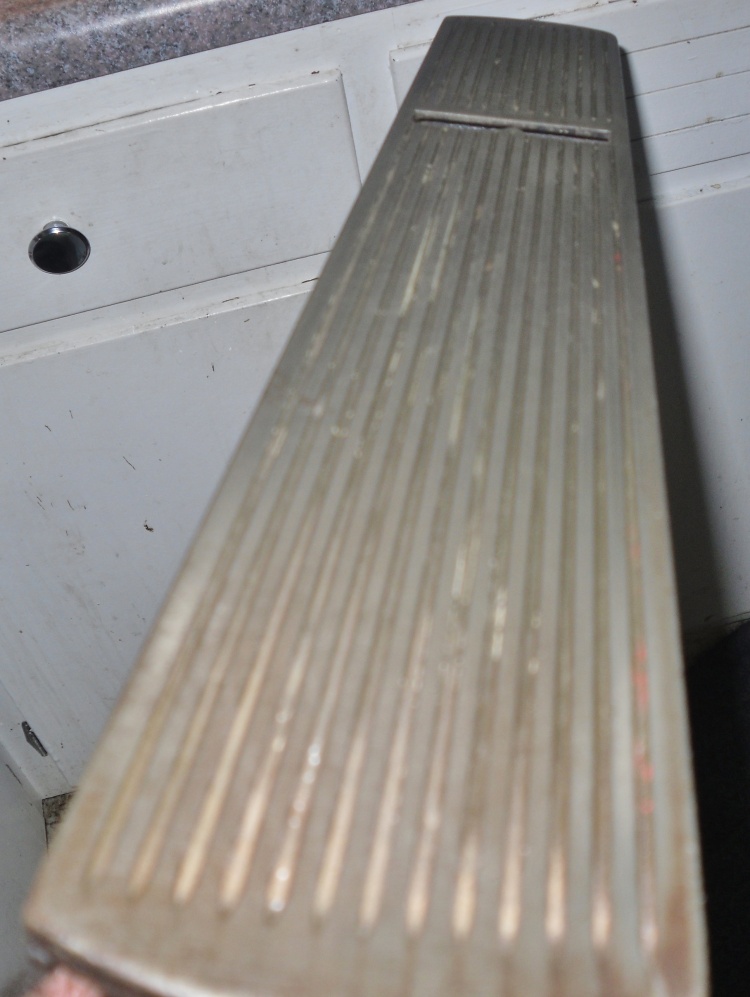

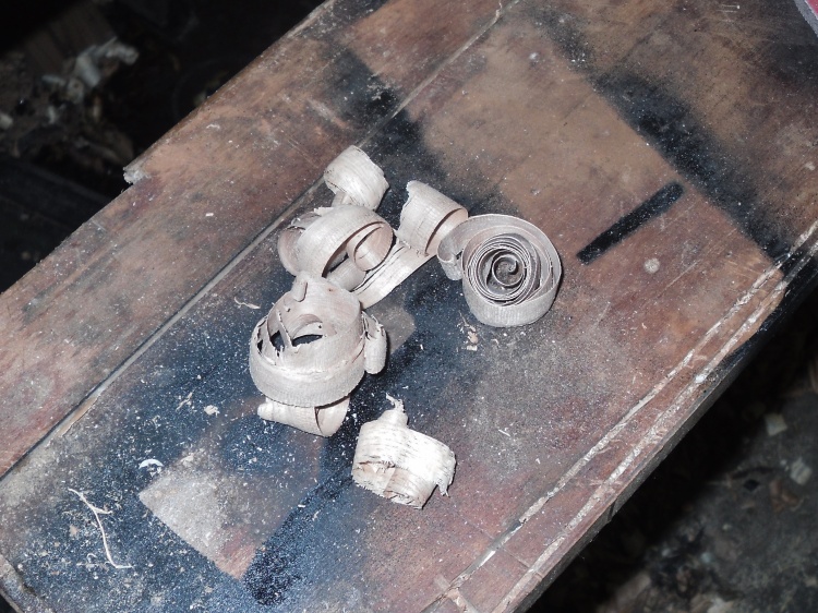

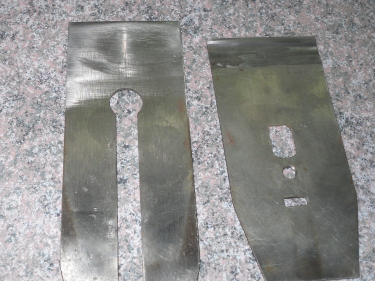

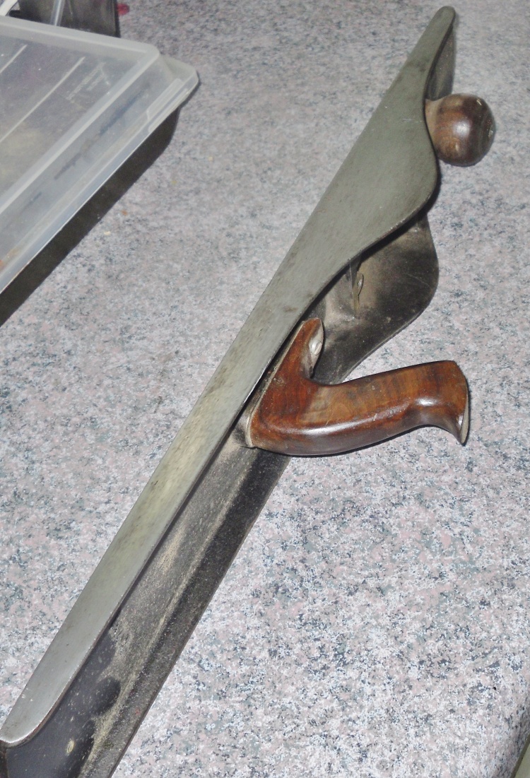

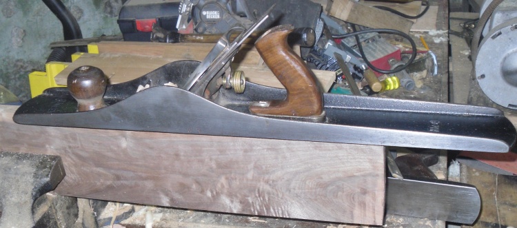

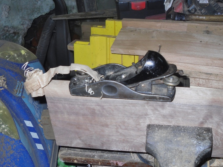

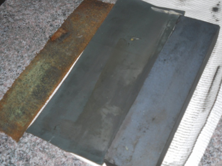

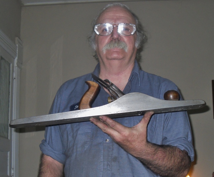

May 25, 201313 yr comment_13120  ala Patrick Leach of Blood & Gore. That "thing" weighs in at about ten pounds!   Sorry patrick, I don't have any "Plaid shirts" in the house. That iron/cutter is 2-5/8" wide!   Edge was out of square by about a 1/16th'' so i had to redo the iron's edge.   drug out the toolsLeather belt as a strop, 1000 grit wet or dry paper, and a 20+ yr old oil stone. Wire brush in the drill press to clean off the dirt and rust.   Then, something new!   A small can of Turtle Wax Metal Polish. Wipe it on, scrub things down with a purple 3M pad, then wipe of with a paper towel.  Plane's sides and sole got the treatmentShould have seen it before.   Rust was setting in. Took some "orange cleaner spray" and wiped away all the remaining dirt/dust/junk.  Drop of oil on some threads, and put it all back together.    Test drive on some Black Walnut edge grainAnd made some Moxxon TPThen tried a block planeon the same plank.  Just showing off...... Planer? I'm the 'planer', and these are what I use... Report
May 25, 201313 yr comment_13124 Now that's a plane!!Lew Kauffman-Wood Turners Forum HostTime traveler. Purveyor of the world's finest custom rolling pins! Report
May 26, 201313 yr comment_13123 Is that a Stanley Prelateral no. 8C? I love my no.8; the width, length and weight make it very stable.Good, Better, Best never let it restTill your Good is Better and your Better is Best. Report
May 26, 201313 yr comment_13122 Your right Steve, that is a plane. Nice job on the rehab. You sure make it look easy. John MoodySite AdministratorJohn Moody Woodworkshttp://www.johnmoodywoodworks.com Report
May 26, 201313 yr Author comment_13121 lateral lever was long gone when I got this ( for a whopping $25 + tax) and by the two patent dates ,and such, this is a type 9.Handles were made by me, since the originals were shot.     Might get replaced.  Planer? I'm the 'planer', and these are what I use... Report
