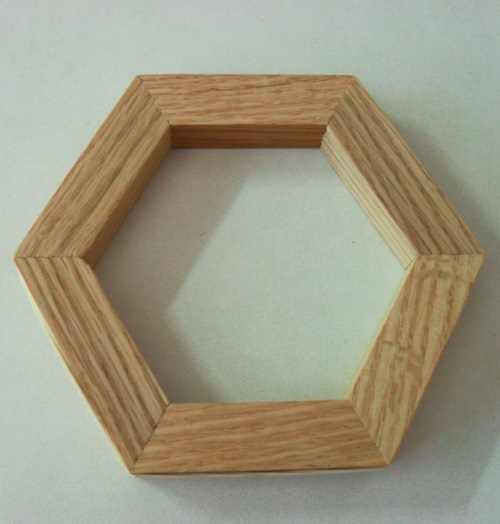

Hello,
I'm cutting some 30 degree mitered angles on the table saw and it's leaving an area that is not cut completely through the board but rather just appears to tear off on the top upper side.  I'm using a 40 tooth blade.  Would an 80 tooth blade prevent this from happening?  Or is my blade too high or too low?
Appreciate any help.

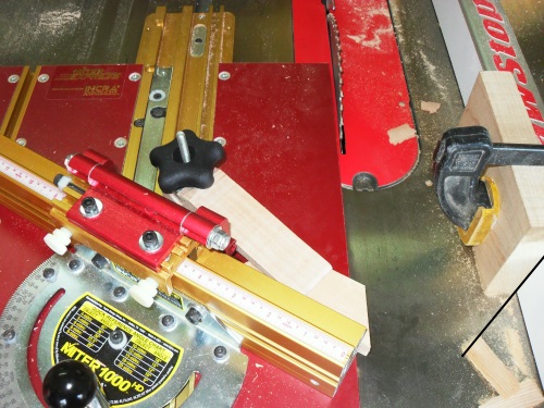

Good to see you!  I don't have an 80 tooth but did put on a 60 tooth blade and raised the blade up.  I attached a picture of the set up.  I believe this is considered zero clearance.

SQ- From your last picture, my guess would be the blade needs to be raised. The problem could be occurring if your sled has a built in stop and it doesn't push past the blade far enough to make the complete cut (with the blade at the original position)

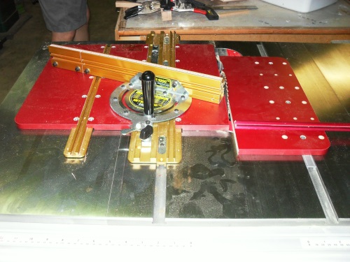

Very good to see you and appreciate your response. Attached a picture of the miter gauge and sled I'm using.

Thanks everyone for all the suggestions.
Changed the blade and also raised the blade up and it eliminated the nip.  :)

Nice tight miters!!

Lewis,
Thank you!  I am so pleased with this miter gauge and sled.  I have been wanting one of these for a very long time.  We tried to make a homemade one but never could get the miters right.  Have my heart set on making a 20 sided box and bowl.  :)  Attached is the eight sided one I just finished.  :)ning-eightsided-12871-93.jpg

An aside: With your sled arrangement, you will not obtain the benefit of the "0" clearance insert. You would need a wider right side piece, so that you could cut through it. You could probably replace the right side with wider MDF, or phenolic covered Baltic Birch, of the matching thickness. With your present sled configuration, as your blade dulls a bit, you'll likely begin to see some bottom side tear out.

We actually have the other piece of the Incra Miter Express but didn't use it because we were using the fence to install a stop block.  Husband plans to router a dado and insert the red track where I show it sitting currently.  We are doing this so we have an adjustable stop block and have the benefit of using the second half of the Incra Miter Express.  Comments would be appreciated.  :)
