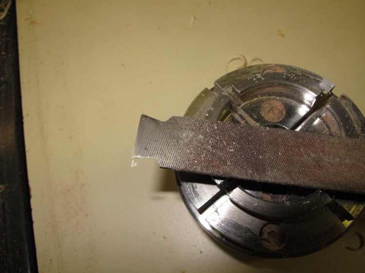

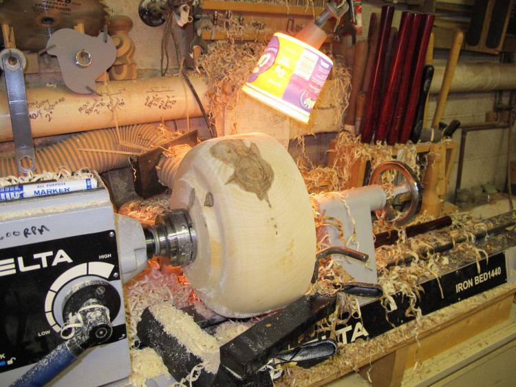

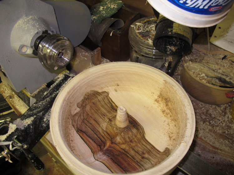

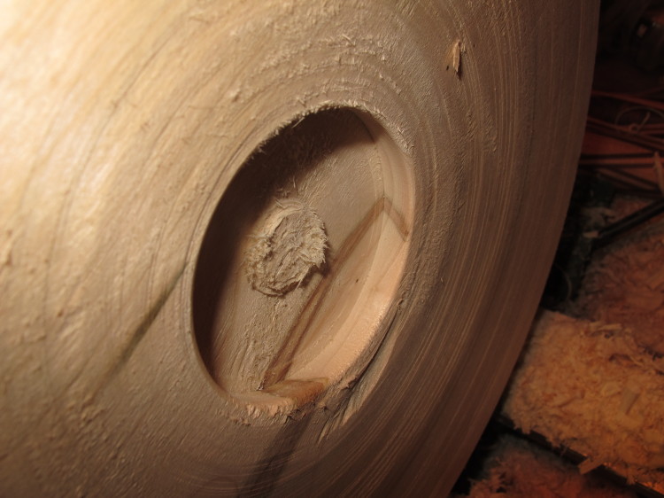

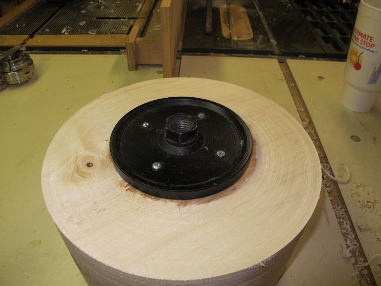

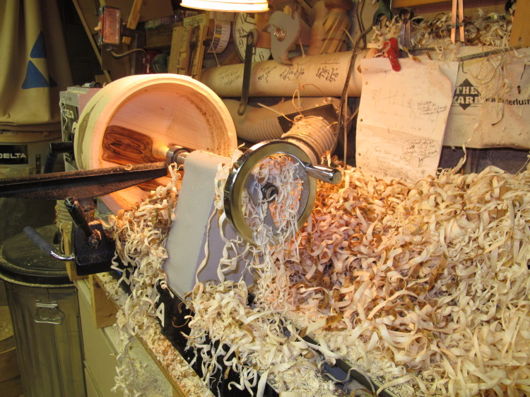

June 6, 201313 yr comment_12767 Well, once I finished fixing the bandsaw, I took that unbalanced blank back and cut it round which significantly reduced the diameter, oh well. So now it was on to turning. A couple things to think about- if you have never turned a bowl. One of the first is to consider how you want to finish off the bottom/foot of the bowl. This may seem backwards but it is important. The other is what methods of holding the piece are available to you. I started this bowl using a faceplate to prepare the blank. Green wood is so much fun to turn!! The faceplate side will end up being the "top" of the bowl. The faceplate mounting screw dig deep into the wood. Making this side the top will cut away the screw holes.  In order to hold the blank for shaping I will use my chuck. I prefer to create a recess instead of a stub to interface the chuck to the blank. Because the chuck jaws flair out slightly, making a "dovetail" style recess provides greater holding power. A simple tool made from a file easily accomplishes the cut. Now it's just a matter of remounting the blank and begin the rough shaping. My preference is to begin shaping the outside of the bowl and the base/foot. The base/foot looks rather large but during the final finishing the chuck recess will be enlarged and the depth reduced to form the final base. Once satisfied with the outside, it's on to hollowing the inside. On this bowl, my goal was to create about a 3/4" thick blank over most of the piece. Getting close! The shavings are piling up! Here is the blank ready to begin the drying phase. I always try and leave a center post in the large turning to provide support. It will get removed during the final sizing. Pictured are the tools and measuring devices used so far- Easy Wood Finisher, various scrapers, large bowl gouge, S-type tool rests (inside and out), straight tools rests depth indicator and thickness indicator. Next time it's about drying. Going to try a new (for me) method. Until then- Safe Turning! Lew Kauffman-Wood Turners Forum HostTime traveler. Purveyor of the world's finest custom rolling pins! Report

June 7, 201313 yr comment_12774 I love reading your blogs Lew! Keep it up!Those shaving are a beautiful sight!Nate Report
June 7, 201313 yr Author comment_12773 Thanks for the kind words, Nate! The pix of the shavings were not "staged". I was knee deep in them by the time I had the bowl roughed out.Nate Meadows said:I love reading your blogs Lew! Keep it up!Those shaving are a beautiful sight!Nate Report
June 7, 201313 yr comment_12772 thought we would send in the rescue crew to find u in all THOSE shavings lol,great lookin bowl Lewis Report
June 7, 201313 yr Author comment_12771 It's probably a good thing the lathe doesn't have a larger capacity. I might never find my way out of the pile of shavings!!!Ron England said:thought we would send in the rescue crew to find u in all THOSE shavings lol,great lookin bowl Lewis Report
June 8, 201313 yr comment_12770 Wow that is going to be a beautiful bowl. Great grain pattern. I just love surprises like that. Excellent write up and picture tutorial Lew. I love it when there are lots of pictures and explanations. That is a good idea on leaving the center post. I have never done that. I'll be giving it a try. John MoodySite AdministratorJohn Moody Woodworkshttp://www.johnmoodywoodworks.com Report
