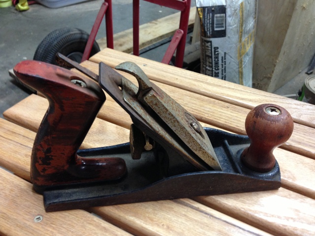

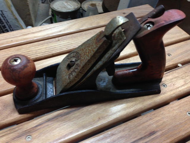

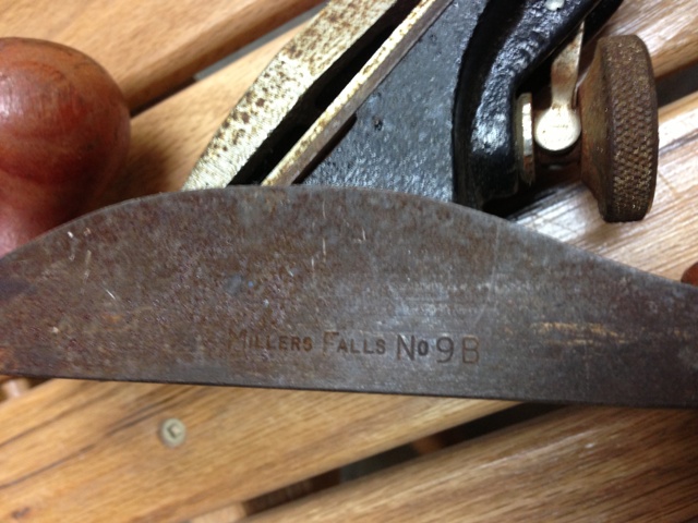

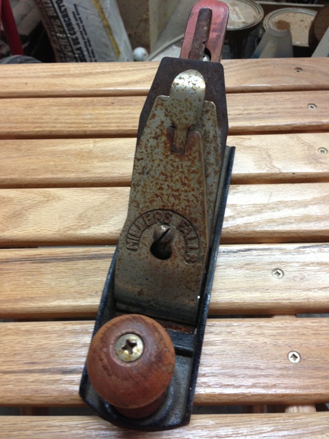

Ran across this Millers Falls plane the other day and picked it up for 8.00. I had a good bit of rust on it but looked okay. I needed something to play with and thought this would be a good one to experiment with.
This plane was made somewhere between 1966 and 1976. It was to be like a Stanley No.4.
So I was wanting to redo this plane.

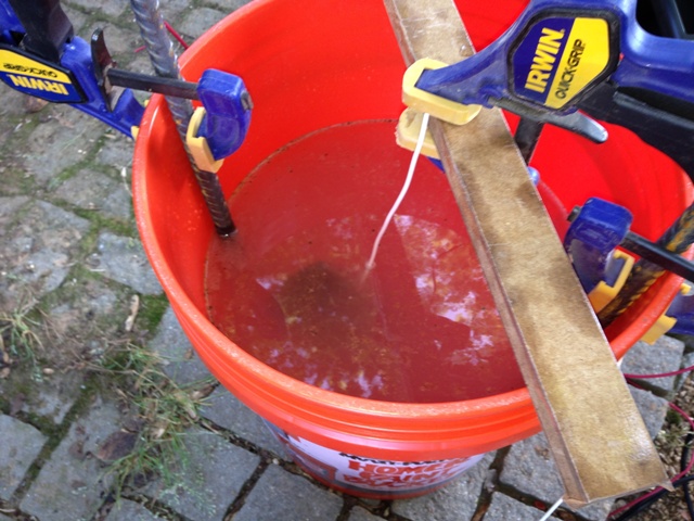

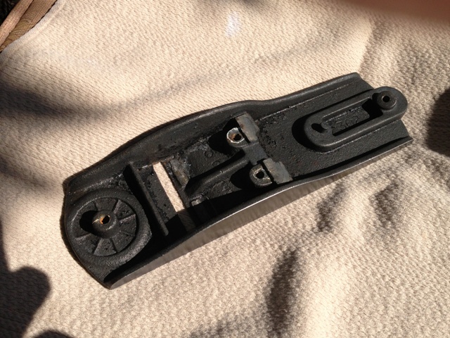

ning-mfbefore5-12735-75.jpgSo with it disassembled I wanted to try the Electrolysis method to remove the rust and japanning from the body and other parts.
ning-mfbefore6-12735-43.jpg You can see the bubbling in the water as the rust is removed.

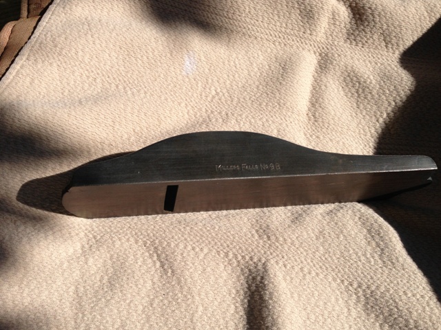

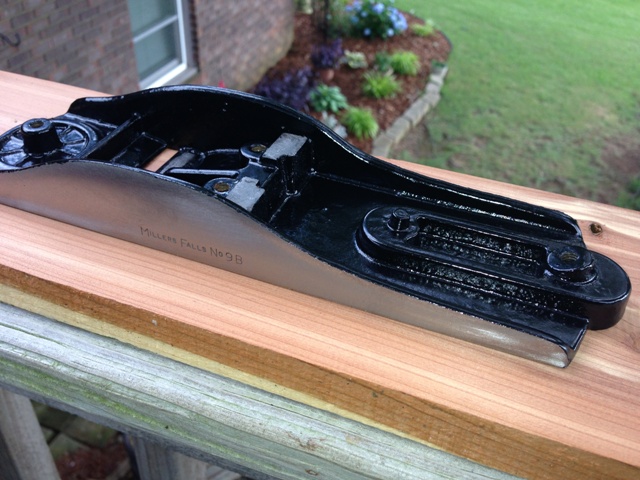

ning-mfbefore8-12735-57.jpgSo after most of the day in the solution here is the body with the rust removed and almost all of the japanning. A little wire brush, picks and it will be clean.

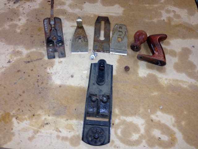

ning-mfbefore7-12735-37.jpgEach of the parts was put in the Electrolysis and the rust removed and wire brushed just to clean everything up.

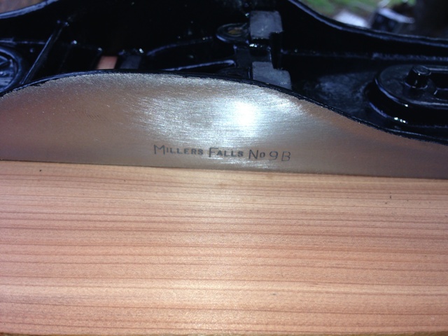

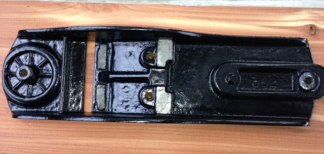

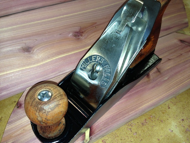

Today I got the body painted and it looks like the original japanning.

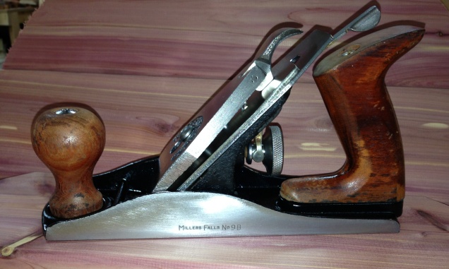

ning-mfafter1-12735-37.jpgning-mfafter2-12735-70.jpgI haven't gotten to work on the knob and tote yet but put it back together just to show you how it looks now.

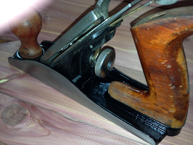

ning-mfafter4-12735-76.jpgning-mfafter3-12735-86.jpgAll of the parts cleaned up really good. I was thinking this is not going to work out but it really did the job and was great for a one armed person. No real work!
ning-mfafter6-12735-62.jpgAs soon as I get to use my right arm and get the strength in it I will redo the handles. Just can't do any sanding right now.
ning-mfafter7-12735-22.jpgSo what do you think? I am pretty happy with it and learned a lot that I will use when I get to start on the Delta Joiner/Saw projects.
I still have a bit of sanding to do on the bottom to flatten it and the blade hasn't been sharpened yet so I couldn't show you any real fine shavings.

Looks very nice John.   What did you use to clean up the body?   That soft swirl pattern looks great.

I was trying to sand it smooth an work up through the grits but just couldn't do it with. My left hand so I stopped. I will go back over it later and smooth it out. But thanks for saying it looks good.

I used Electrolysis to clean up the body.
You can read about it here in an article Larry, he site host for Old Woodworking Tools posted. I tried it and it worked really well.
http://www.thepatriotwoodworker.com/forum/topics/rust-removal-by-electrolysis
Larry it worked really good after I got an old battery charger bat the flea market for 4.00. The new one I bought was too smart to run after the battery was fully charged. I have already used it on several other small items. Getting my practice in before tackling the saw/joiner.
