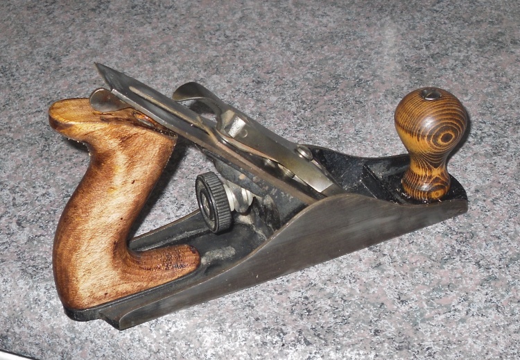

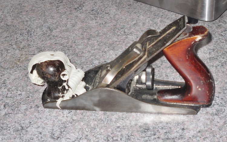

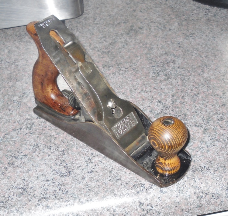

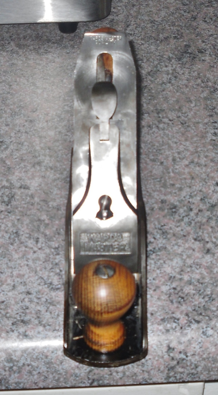

Got to the point that all the metal work was done.    Iron flattened, and scary sharpped,  found a bolt to hold it to the refurbbed chipbreaker.    Sides were cleaned, and the sole as wellning-sdc15253-12720-48.jpg?width=750But, something else said "Refurb me!"    Ah, the handles!    They had a nasty looking, vile smelling, THICK sort of "Finish".      Tote was smooth, though.    Time to get to clean up the woodsning-sdc15258-12720-51.jpg?width=750Even shined up the lever cap!     Knob look a little more "presentable"?    This is a WWII era Wards Master #3.    Another view?ning-sdc15259-12720-40.jpg?width=750Like the "plastic" wheel.    Don't think I can "polish" it up, though.   My finish is a little thinner.    50/50 Minwax gloss, and BLO.    Brushed on, and then wiped down with a big handful of Cherry shavings. One more look?ning-sdc15262-12720-6.jpg?width=750Well, maybe the other views will look better...

 knob was spun in the drill press, with lots of sandpaper.
tote was wire brushed down to bare wood.   Brass wire brush in the drill press.
