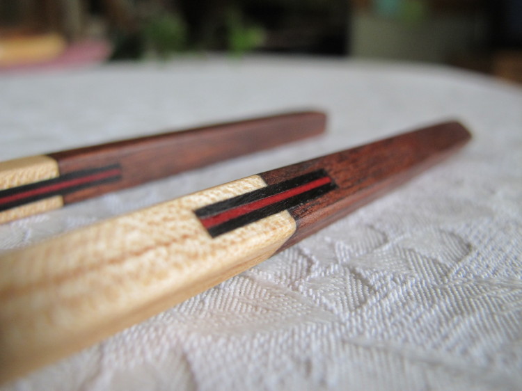

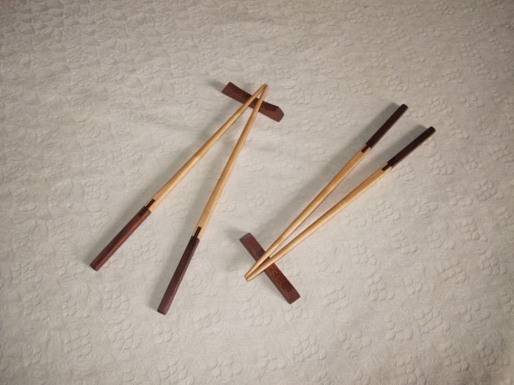

The June/July issue of Woodcraft Magazine had a bunch of neat projects. Tried my hand at one of them. These were made from Walnut and Maple. The author used Bloodwood for the spline. For mine, I used African Blackwood and red fiber material that is used to dress up knife scales.The entire project was glued with Titebond III. It might have been a little more contrast if I had used 2 red and 1 black section in the spline but I wasn't sure about the overall strength of the red fiber material. The little rests are made from Sapele. Everything has several applications of mineral oil.

John, I just peckered around doing these as I was subbing at school last week. The only time consuming part was the test cutting/fitting the spline. Because I wanted it in 3 pieces, it took about 20 minutes to get the table saw setup for the African Blackwood pieces and the fiber board to fit snugly into the slot. Also, I don't have a flat ground table saw blade so I had to do a little finish work on the "bottom" of the slots to assure they were flat. The glue/clamp operation was typical. The tapering was done on the belt sander- just a few minutes there. I  made the glue up/stock wide enough to make 3 sets but you could easily make it up for 6-8 at a time. Finish is wiped on mineral oil over a several hour period (3 applications). The little stands were done on the table saw, oscillating drum sander and the bandsaw. Probably only 20 minutes total plus a little for sanding/finishing. The stands can also be made in quantity by using a long piece of stock.
