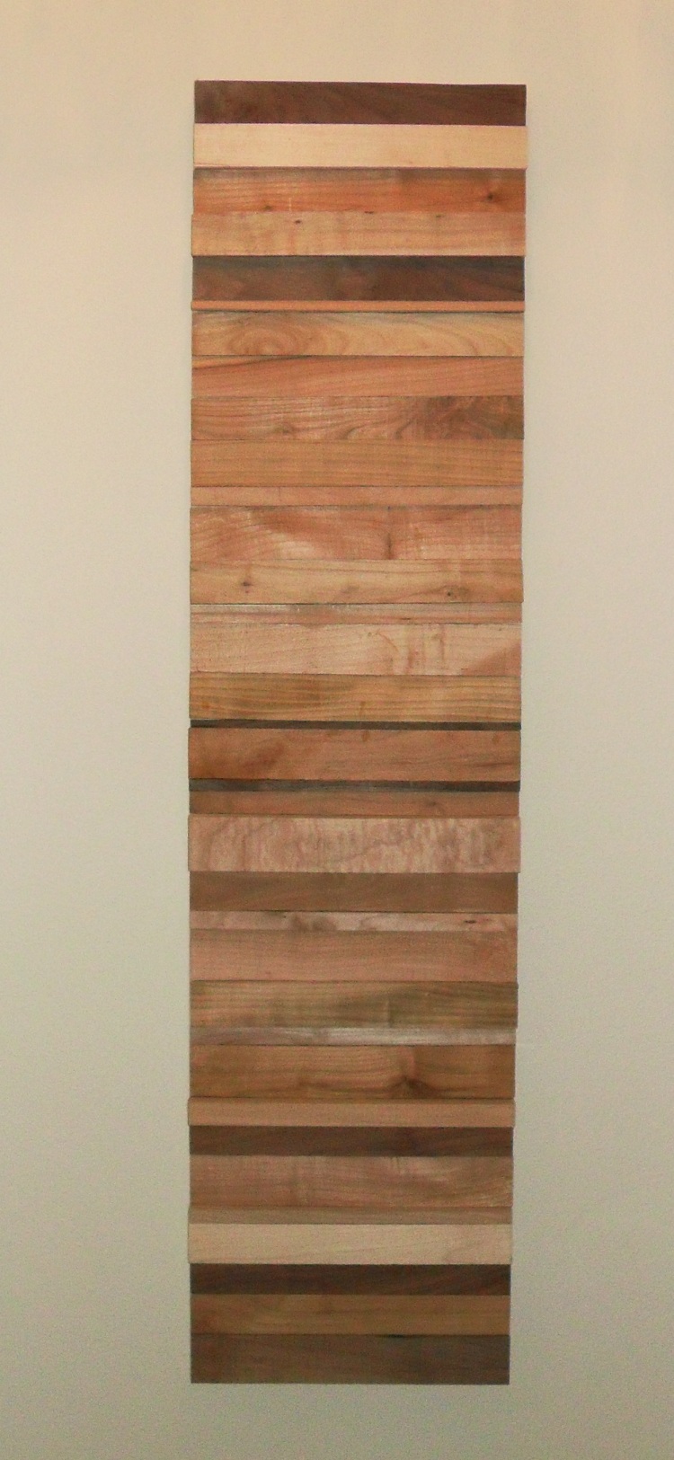

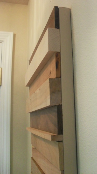

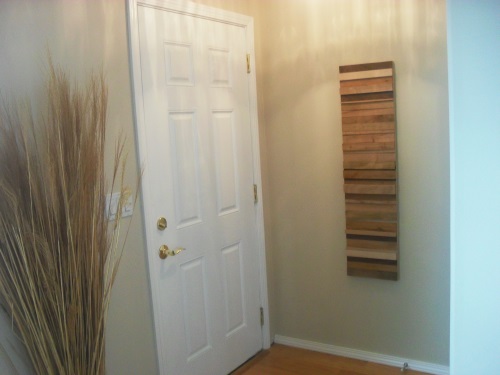

Randomly Wooden:
First I painted the canvas for a background color.  Cut the wood to the width of the canvas with a chop saw, and glued on various types of wood with different thicknesses using wood glue.  Used painter's tape to hold the wood firmly onto the canvas until dry. Wood was left natural - no finish.

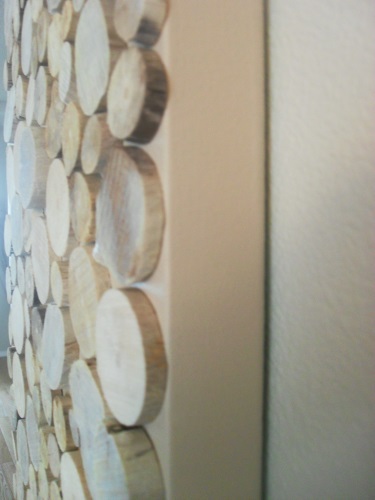

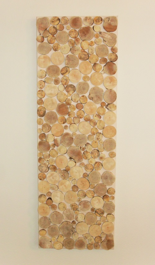

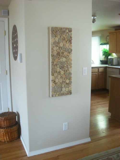

The Drifter:
Painted the canvas.  Cut driftwood I had collected at the beach into 1/4 inch pieces on the band saw.  A few pieces were cut just a bit thicker for added texture.  Next sanitized the pieces in water and bleach for 24 hours. Rinsed and allowed pieces to dry.  Once dry, glued pieces in place using wood glue.   Driftwood was left natural - no finish.
