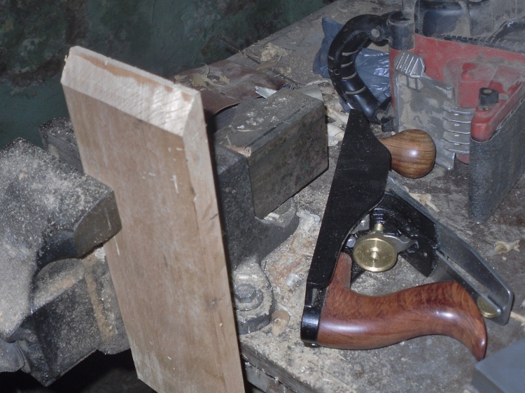

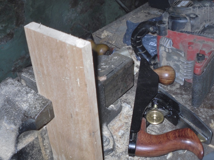

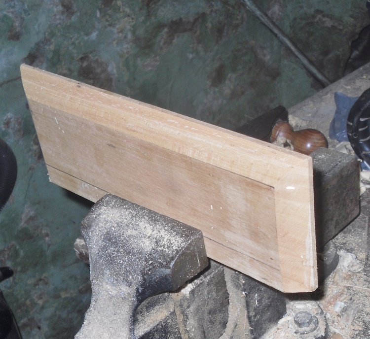

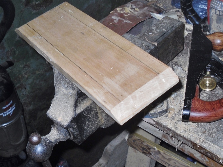

June 13, 201313 yr comment_12544 Well, I got to watching Paul Sellers Vids awhile back.   Decided to try one of his ideas out.   I took a 1x4 and clamped it in my vise.  The cast iron and wood object there comes next..this is actually the second end I worked over.  Shaved the first end until i liked what I saw, and then used that to mark out the other three sides. When going across the grain like this, keep the plane at an angle to the grain.   Little if any tearout that way.  Then i marked out the two sideswith a combe square and a pencil. Placed it back in the viseuntil the angle at the ends matches the side's angle.  I almost split the line on this one.  Flipped the boardand do the other side.  Planes are set very coarse to start, then backed off as i went until a glass smooth surafce is left, even on the end grain.   Of course, IF one has a few "extra" planes handy... It does work.  Makes a mess of the "clean" floor, But it do work.   I start to form the outside edge first, to set how thin an edge I want.   Next, I try to plane until the lay out line on the face is split.   Then i just plane until the bevel is flat and smooth. I'm not as fast as mr. Sellers is, but this panel might have taken ......15 minutes???/ How much bevel, and how wide a bevel is up to you. I tried to get around a 1/4" at the edge. Just playing around today, waiting on a #4 powrkraft plane from Nevada to show up in the mail..  Report

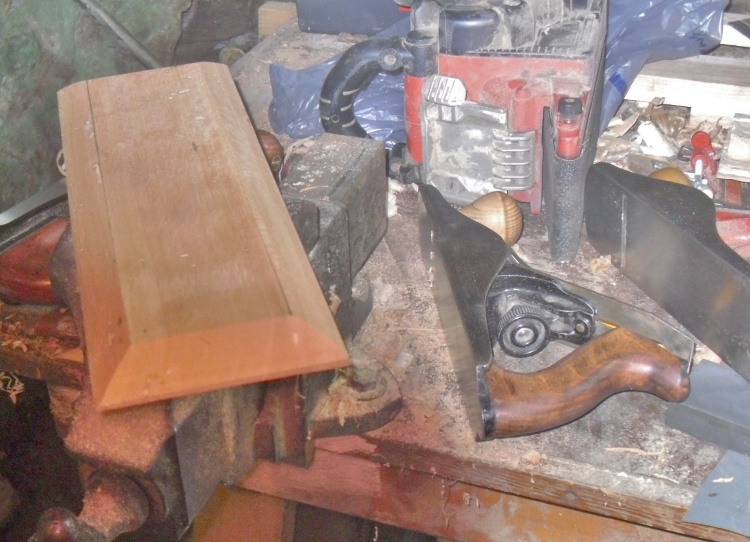

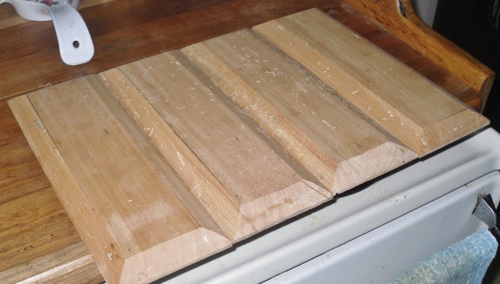

June 13, 201313 yr Author comment_12558 Now have a second one done!    Doesn't take all that long, either.hardest part:   getting a flat surface on the bevel.    One is a bit of a "Roundie".      Both the Millers falls #9 and the Wood River #4 V3 were cutting end grain like butter!     The Wards Master #3 was set nice and coarse to start the bevels.    A Dunlap #4D BB was used to finesse the bevel a bit.   Then the "fine set" ones took over.  Easy when one has a couple extra planes to use.... Report
June 14, 201313 yr comment_12557 Steve, that is way cool man, I love raising panels by hand, there is something warm about the not so perfect lines. Great job man! How's that No. 4 acting? Report
June 14, 201313 yr comment_12555 Nice Steve, most excellent!steven newman said:With the #4, no need for sandpaper...... Report

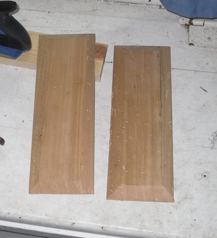

June 14, 201313 yr Author comment_12554 panel #3 is now done, one more to goI am getting better at getting it TO the lines.    This one was just a two plane deal.   A Wards Master #4 set coarse, and a Millers Falls #9, set super fine.     I can go back and final "sand" with the WR#3...... Report
June 15, 201313 yr Author comment_12552 Just got done with #4.    Takes about, for me, 15 minutes.   I would be quicker, but I have to change planes to finish each face. Report
June 15, 201313 yr comment_12551 This might be a dumb question, but why do you have to change planes to finish each face?  15 minutes sounds really quick.  SQsteven newman said:Just got done with #4.    Takes about, for me, 15 minutes.   I would be quicker, but I have to change planes to finish each face. Report
June 15, 201313 yr Author comment_12550 One is pre-set for a thick cut, the other for a very thin finish shaving.  15 minutes is quick for me, however, watch Paul Sellers do the same type of panels, with just one plane, in about ......FIVE Minutes.    Video is only about 6 minutes long.Note:  that fellow has a whole shelf FULL of nothing but #4 sized planes, makes my little collection look down right puny! Report

June 17, 201313 yr comment_12547 them planes gotta be really sharp to clean off end grain like that. Report

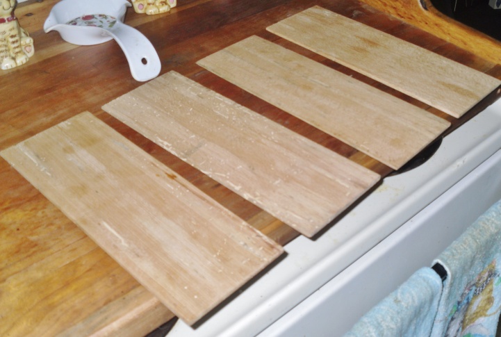

June 17, 201313 yr Author comment_12546 Planes are as sharp as I can get them.   I go at the end grain at a skewed angle.   About a 45 degree or so.   The wood river #4 WILL go across the end grain, though.   As I said, I now have four panels donewent from these four wormy blanks of Barn Wood ( Sycamore, maybe??) tothese four raised panels.  Just a couple handplanes did the work, no sanding needed.   Still need to build a few frames to house them.    Picked up some Pine scraps for inside parts.   Still have a nice stack of this Barn wood for the outside stuff. Sketch-up being a few over-used (abused??) brain cells, project is going at a "Fuzzy" pace.  Details are still being worked out, lots of "Sleep on it" type of plans. Report
