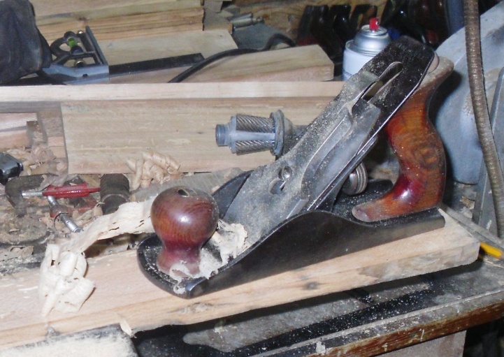

The other plane that came today?    Weeellll, It took a lot to fix up the iron.    Turns out the chipbreaker is also causing it to bend a bit....  Might be a new set coming for this one....

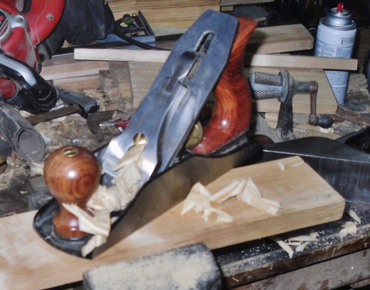

Sharpened both irons up. The WR #4V3 was just a strop jobning-sdc15327-12323-34.jpg?width=721will take a bit of fussing to get it to the factory settings.   As for the No-Name Barn Planening-sdc15325-12323-10.jpg?width=721Gave it a test drive on some wormy Barn Wood, to make it feel rihat home..
