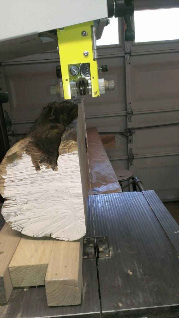

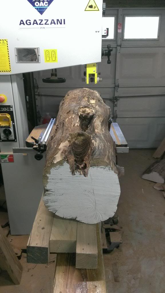

June 27, 201313 yr comment_11990 I made a fairly long sled from two long pieces of wood with little spacers. It's as flat and square as it needs to be. The length of the sled is relative to the length of the logs I resaw. I screw it to the log leaving an overhang of uncut log on one side. Then I use that sled on the table and against the fence to get the first straight flat cut. Then I flip the whole schamoodle 90 degrees so the newly cut side is bearing oon the table and the sled is against the fence. Then with two fairly square and flat cuts done I remove the sled Here's the first cut See the nice flat cut square to the table? Hey~!! It's a hobby~!! It's not supposed to make sense. Report

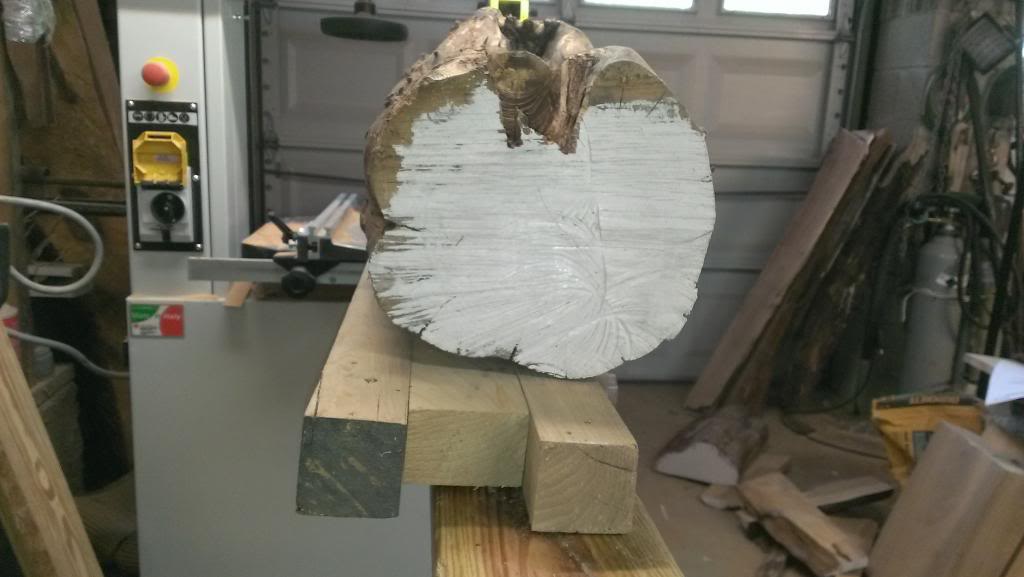

June 27, 201313 yr Author comment_11996 That is a piece of apple felled by the big October snow storm two years ago. I cut the logs from it up this weekend.I sawd up the logs into 2.5" thick cants. I have a hankerin to make me a nive end grain cutting board.Never made one and I'm jonsing for one that literally rings when a knife raps it. Apple is beastly hard & dense stuff so I'm hoping it'll do the trick.Hey~!! It's a hobby~!! It's not supposed to make sense. Report

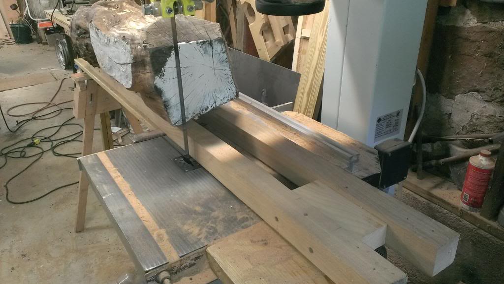

June 28, 201313 yr Author comment_11993 I learned my lesson about trying to muscle a log without the benefit of a sled by kinking a $200.00 blade.That led to some thought on the subject and that led to that sled which I keep around.I've seen guys using a sled/jig that they destroy when using it because it's just a big V ( with a base) into which the log sits and they gotta saw the jig up as they saw the log. I suppose it's good if you are doing a one off. But I like my reusable sled. I made it long to handle a variety of logs.I'll also clamp a 4-foot long jointed 2x6 to the table to act as an auxiliary fence so that I have a larger surface against which to bear when pushing the long work through a cut. It's handy because the longer heavy pieces tend to be difficult to control when a large portion of them are outboard of one end of the fence or other.I hammered most of the kink out of the blade and still use it. It's the blade I use for this sort of thing. I won't cry if I kink it again. Report
