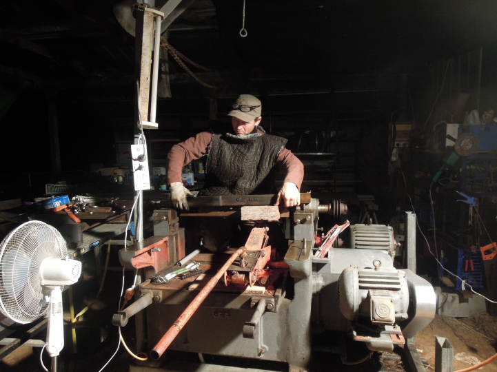

July 5, 201313 yr comment_11722 hi all i have just started work on an old wadkin 24" jointer thicknesser it is in fair condition and i will only be doing the minimum strip down and clean up ( checking bearings etc) to get the old girl running again.be looking for a 300mm wide jointer for a while and this monster came up for $1000 australian .$ 500 to move and i am hoping $ 500 at most for parts and disposables .i am looking for any information on this model especial modern bearing codes .cheers scott Report

July 6, 201313 yr comment_11731 Scott, I just sent a message to a member that is heavy into Wadkin machinery. When he gets back to me I'll forward the information from his reply. Â Larry Old Woodworking Machinery Forum Host Report
July 9, 201313 yr comment_11730 Scott, Here is a link to quite a few Wadkin manuals. http://www.daltonsmachines.com/downloads-old.html This is a direct link to the RM manual. http://www.daltonsmachines.com/uploads/files/oldmanuals//Wadkin_RM_(16,_24_inch)_Planer_Thicknesser_Manual.pdf Sorry about the delay. Â Larry Old Woodworking Machinery Forum Host Report

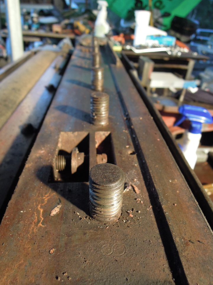

July 9, 201313 yr Author comment_11728 thanks john lewis and larry yes she will be a great machine , so east to take apart ( nice cut threads into cast ) no threaded or stripped heads. just bloody heavy .. removed the cutter head and will need to replace the bearings one has collapsed so very pleased i decided to give the old girl an look over . trying to source bearings at the moment i worked on a machine like this during my apprenticeship in England in the late eighties it will be noisy but will eat wood even aussie hardwood ( and man some of that is hard as nails ) also need to replace the bed roller bearings and housings . as they have damage . might try and mill the housings in aluminium on the small cnc i have been trying to master . cheers scott cheers scott Report

July 10, 201313 yr comment_11725 Scott, Could you post a photo of the other side, so I can see the drive setup, and bearing mounts? Â Larry Old Woodworking Machinery Forum Host Report
