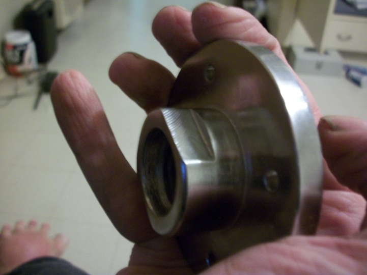

Hi if the faceplate is stuck badly, maybe a shot of WD40 will help loosen it up , just spray it on the outer portion of the spindle and let it set an hour. maybe that will work. If it's still stuck you can maybe use vice grips on the flat spots that should be on the back of the plate like this one.
ning-000-0002-11639-46.jpg?width=721
You may also try using a mallet on the vice grip while holding onto the Quill to keep it still. As a last resort Try a hammer or mallet on the back of the faceplate (knocking it forward if only a millimeter or so just enough to loosen it).

That little faceplate you have there Charles would be removed easily  by using those lovely little holes even without the lovely  wrench flats on the threaded collar.
