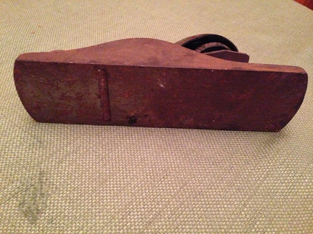

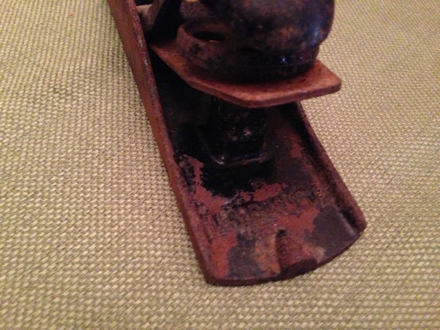

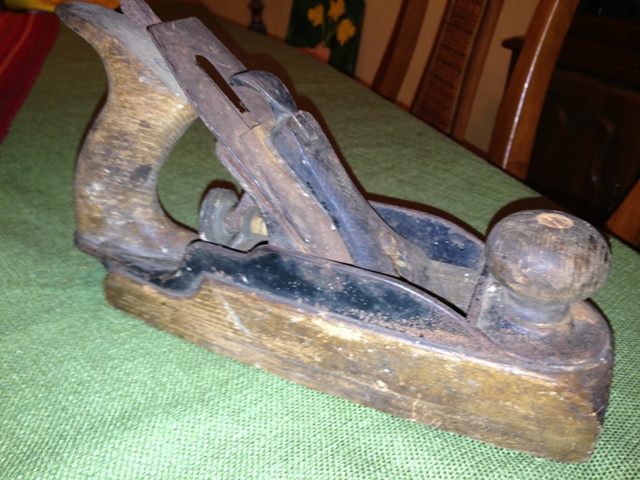

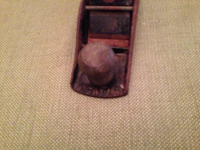

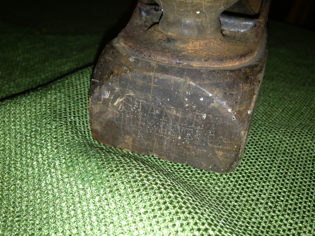

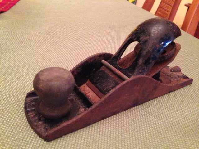

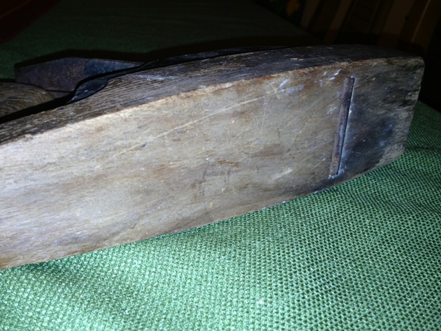

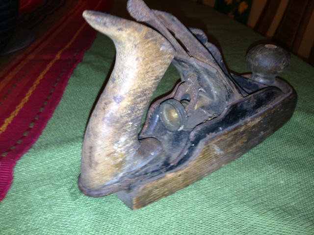

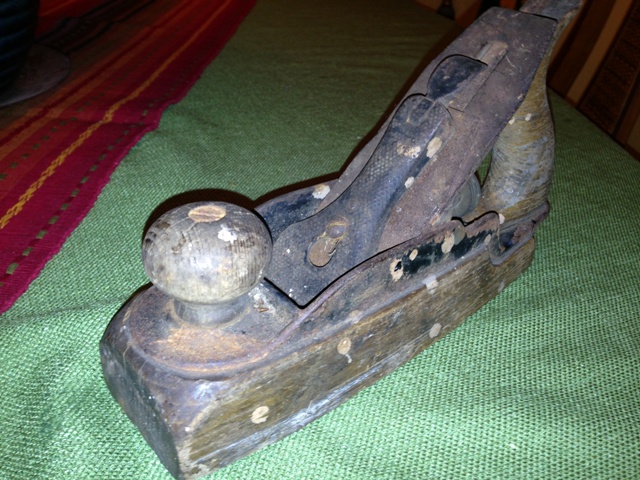

July 9, 201313 yr comment_11569 Got out Saturday with my Bride and started working our way north into Tennessee. We were hitting a few Antique shops just looking around. I ran across a couple of planes at the last shop we were in at the end of the day. We were up in Springhill, Tn. So sitting in an old box was this little Stanley 110 pretty rusty. So it was jumping out to me saying take me home and clean me up. So I did. Then walked into another store across the street and saw in a back room a Stanley No.35 Transition plane. Also this one was in pretty rusty shape, but then again it is over 100 years old. I would love to leave it as is, but it is so bad it really has to be cleaned up. A few small cracks in the front mainly from just the wood drying out. No cracks or breaks in the cast iron but a good bit of the japanning is gone. As bad as I hate to, I will clean it off and redo it. I will probably soak the body with some Linseed Oil which is what it would have had on it new. So I guess I have a few more projects to work on. Steve you got me going man! John MoodySite AdministratorJohn Moody Woodworkshttp://www.johnmoodywoodworks.com Report

July 9, 201313 yr comment_11579 Love that transition plane John. It's a beaut. And don't' forget, you can always set it up on a mantle or shelf as is in your home as well, they make great decorator pieces in the home. I have a couple around our home too, just milling about, leaning up against a wall here, there, or next to the fireplace. Great find my friend! John MorrisThe Patriot Woodworker Report

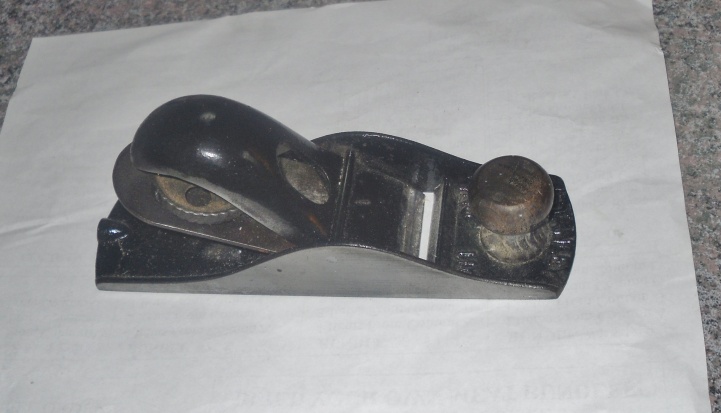

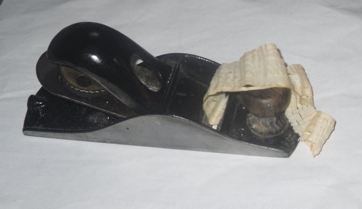

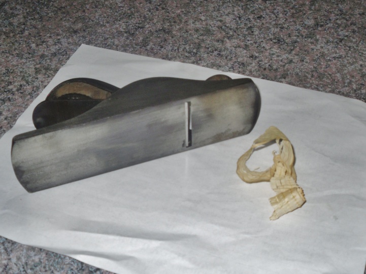

July 9, 201313 yr comment_11578 More inspiration?  Here is My Stanley #110Seems to look almost like new?   Works like itBe sure that the sole is flat, the iron is too.  Bevel goes up.   Be sure the edge of the iron is straight across. Polish the back IF you want.   Be sure to polish the area where the iron rests on the body. Set the iron so you can't feel the edge sticking out, then LIGHT taps to set the depth.  be sure the iron moves straight as you go. Anyone can get this to work.... Planer? I'm the 'planer', and these are what I use... Report

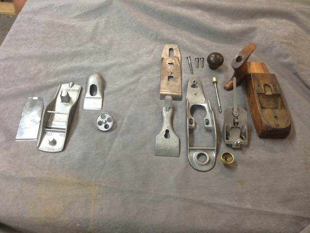

July 10, 201313 yr Author comment_11577 Well your faster than I am Steve. I did get them cleaned up tonight, so I am ready to start putting them back together. So they are all cleaned up. I took them down to the bare cast. John MoodySite AdministratorJohn Moody Woodworkshttp://www.johnmoodywoodworks.com Report
