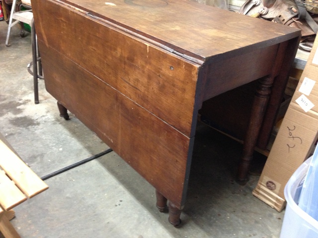

While out prowling around with my lovely Bride the other day, I saw this old table sitting in a corner of one of the stores we were in. I notice right off (cause I'm shape like that), that it was a gate leg table. I looked at the price tag on it and did a double take. $95.00 and it said it was Walnut. I looked a little closer and I think it is Cherry but I could be wrong too. Anyway I ask the shop owner if I could pull it out and look underneath. The knuckle joint on the gate leg had been broken and someone put two triangle metal hinges on the gate legs on both sides.
Looking at the table it had some nice character to it and it my best "Picker" attempt I offered the guy 75.00 thinking the wood would probable be worth that. Well it didn't take him long at all to hand me the hand shake and agree to 75.00 - I knew I was too high!
So we brought it home and set it in the shop to become another project I will be working on at some point. I really want to get it up on the bench and take a better look at the bottom and see if the wood is Cherry or Walnut. On Sunday we were in another store that afternoon and saw on just like it with the knuckle joints intact. The price on it was $695.00. I am hoping I can repair the knuckle joints and clean up the circles on the top without doing a lot to the original finish and patina it has.
ning-img-0985-11553-9.jpgThis side has a crack along the whole board, but each leaf and the top are one piece each one 21" wide. It has the original hinges in the leafs so I hope I can redo the knuckle joint on the legs. it even has the original brass/wood wheels on the bottom of the legs.

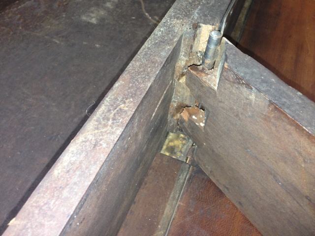

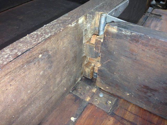

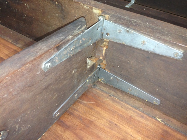

Today, 7/13/2013 I got the Gate Leg Table up on the bench to finally see under it. Wow what a mess.

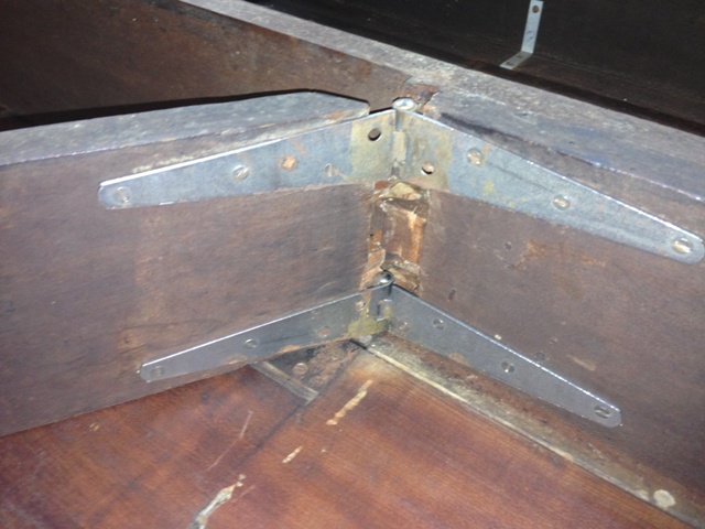

ning-img-0101-11553-85.jpgHere is the broken gate leg on one side. It is pretty bad. I am sure who ever did the repairs was not a woodworker.
ning-img-0102-11553-75.jpgNice Hinges
The other side is the same.

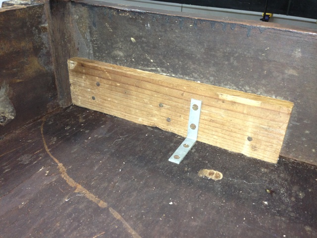

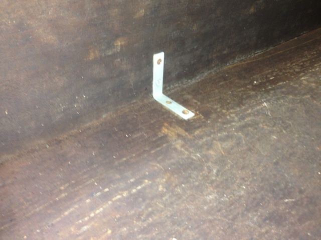

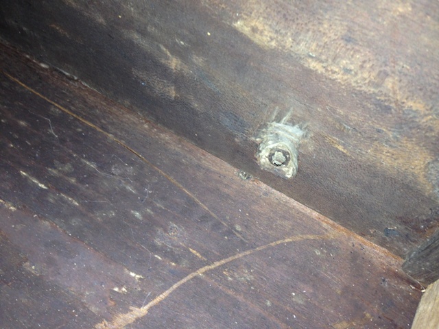

ning-img-0103-11553-49.jpgning-img-0104-11553-88.jpgThe original table top was attached with pocket screws. Again a poor repair.
I am afraid to see behind this patch.
ning-img-0110-11553-77.jpgSo I guess I got my work cut out to put this back to a useable gate leg table.

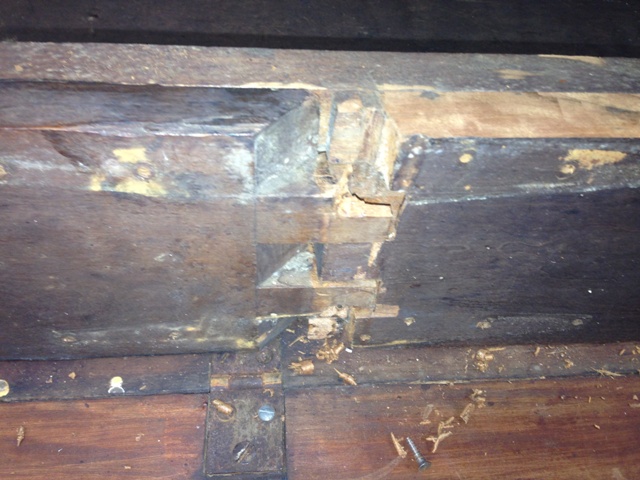

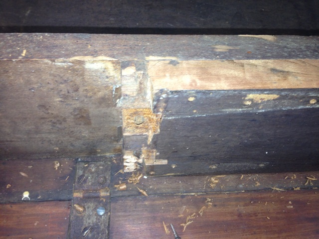

Last night I got a chance to remove the metal gate hinges from the gate leg or swing leg table. This gave me a chance to look at the damage to the original knuckle joint.
This is the half of the knuckle that is attached to the apron. The bottom (table is upside down) piece it broken off complete. The top (closest to the table top) is split in half. I have hoping that I can remove this piece from the part of the apron it is glued to. If I can remove it them I will make another knuckle joint for that side.
This is the other half set in to match up. It is pretty well split also. I think I can just cut off the end of this piece and re-cut the tenons on this piece. Then drill the hole through the two pieces and install a piece of brass stock.
I too one of my block planes to the bottom of the apron and the wood is most definitely Cherry and not Walnut as they had on the label. I told the man in the store I was pretty sure it was cherry when I was looking at the grain on the top.
The other side is the same as this one.
