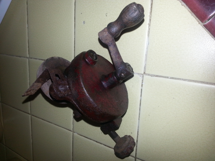

August 15, 201313 yr Author comment_10377 Thanks Dragon1 so much for the info! I've been trying to decide what age hand cranked grinder my character would be using and have narrowed it down to one from 1900 (first pic) or one from 1920 (second pic). Would you have any perspective on whether an average boatbuilder in 1937 would likely have a 10+ year old grinder like from the 1920's or an even older one from 1900? How expensive were these for the average woodworker of that era? Would it be common to keep one of the older ones in working order for over 30 years if well taken care of? Would an average woodworker be able to make improvements or fix the workings? Report

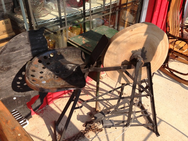

August 15, 201313 yr comment_10376 Possibly, a boat builder might need a unit like one of these pedal powered units. Faster, with a better stone for sharpening. It leaves both hands free to control the blade and, once you get it spinning, it will spin on it's own for a few minutes. Just need to pedal it every so often. Don't think that these are of the appropriate age, though. Having used one of these (much older) to sharpen hoes, axes, knives, scissors etc. I can attest to their ease of use. Ours had a water bath under the wheel and was retrofitted with an old tractor seat. Gene'The true soldier fights not because he hates what is in front of him, but because he loves what is behind him.' G. K. Chesterton Report

August 16, 201313 yr comment_10374 the top one has another space to the left for a muslin wheel.Valarie Farnham said: Thanks Dragon1 so much for the info! I've been trying to decide what age hand cranked grinder my character would be using and have narrowed it down to one from 1900 (first pic) or one from 1920 (second pic). Would you have any perspective on whether an average boatbuilder in 1937 would likely have a 10+ year old grinder like from the 1920's or an even older one from 1900? How expensive were these for the average woodworker of that era? Would it be common to keep one of the older ones in working order for over 30 years if well taken care of? Would an average woodworker be able to make improvements or fix the workings? Report

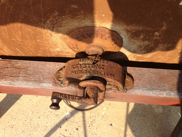

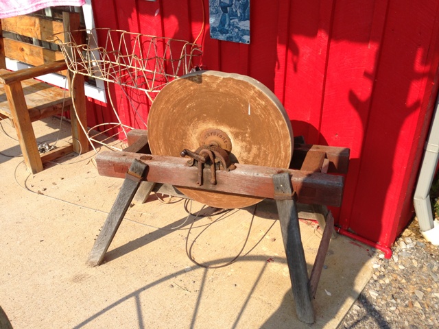

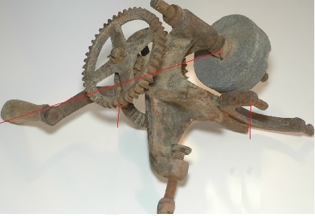

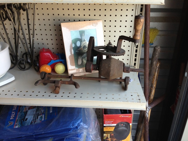

August 26, 201313 yr comment_10368 Here are a few grinders I ran across this weekend at a few Flea Markets. This one was patented in 1866 And this small hand unit. John MoodySite AdministratorJohn Moody Woodworkshttp://www.johnmoodywoodworks.com Report
August 26, 201313 yr comment_10367 That last one looks like and old sharpener used for hay cutting blades. Report
August 26, 201313 yr comment_10366 Could be Mike, I had never seen one like it but I never had to sharpen any hay cutting blades. It just looked interesting.dragon1 said:That last one looks like and old sharpener used for hay cutting blades. Report
