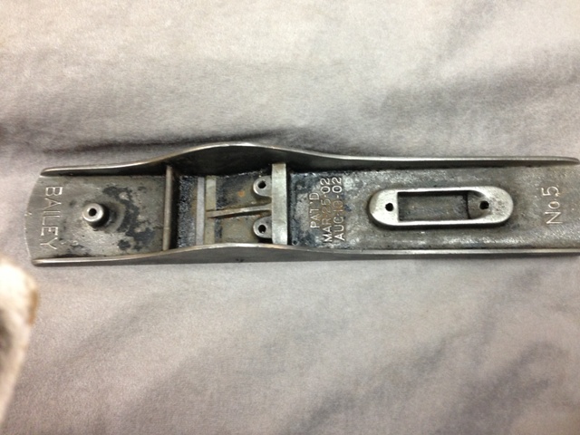

Sunday afternoon will be some rest and maybe spent setting up the spray booth. I am also running the Stanley No.5 through the electrolysis to clean all of the rust and the rest of the japanning from the body so that I can get it restored. Parts to replace the bad parts should be here today so maybe by the middle of next week it will be looking good.

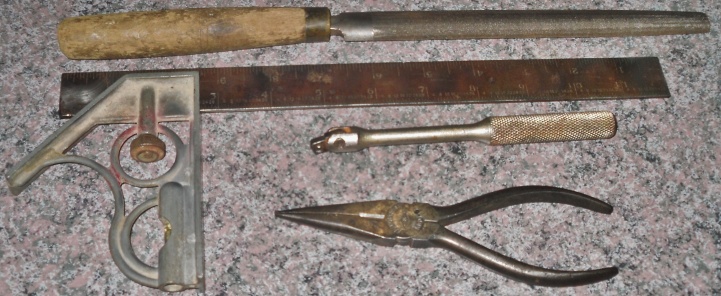

Rust Hunting today:
$1 got a 1/4"drive breaker bar, aKreauter 6" needle nose pliers,  a Grobet USA 8" long half round wood file/rasp, with handle, a no-name combo square with a small level in it.

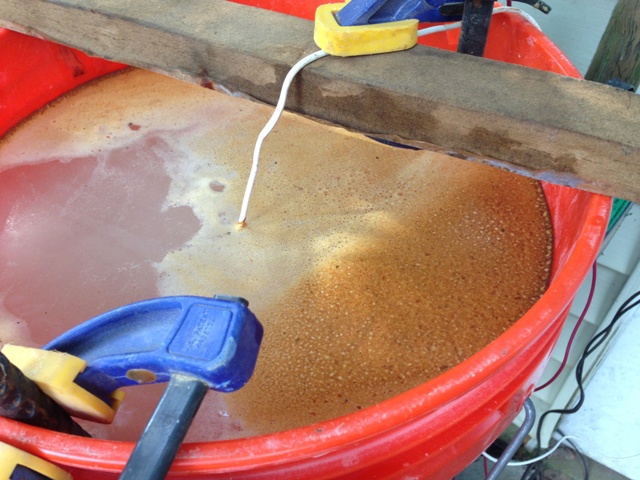

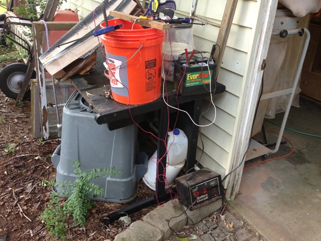

Well Gene, I got home late Friday night, spent all day Saturday in Nashville and have been on the go all day today. So I am just now getting to the answer of your question.

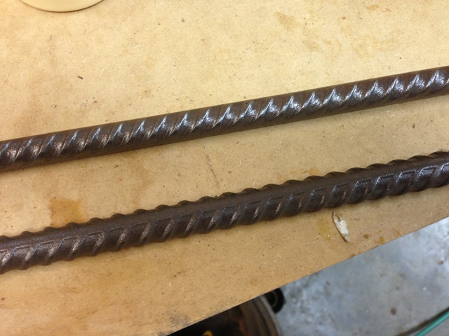

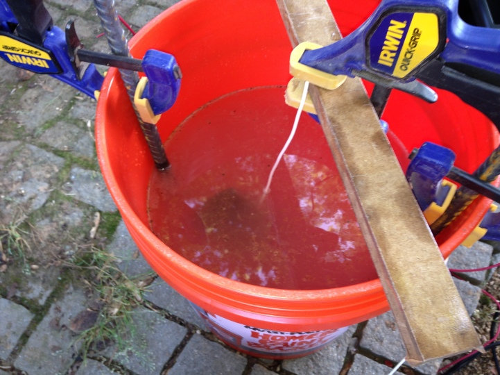

Here is what I start with. I have a couple of pieces of rebar that I use.

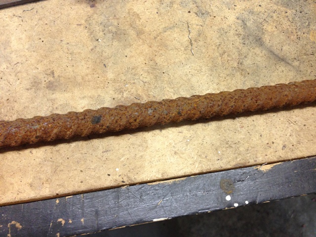

ning-img-0724-9994-75.jpgWhen you use the rebar, it will gather the rust to it. So when I am ready to do another one, I clean the rust off both of them.
ning-img-0725-9994-51.jpgI connect the hot wire to the rebar and the negative wire to the piece I am going to clean.
ning-img-0726-9994-20.jpgClamp them in the bucket with the solution.

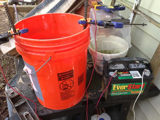

Connect the unit to a battery charger and you need one of the old models. The new ones will shut themselves down if the battery doesn't need charging. So I got an old one at a flea market for 3.00. It works great.

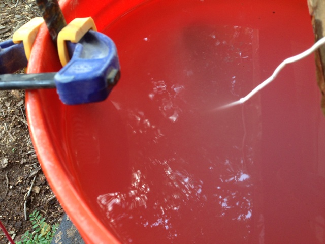

ning-img-0729-9994-65.jpgEverything connected and the process will start and you will start seeing little bubbles coming up to the top and the rust coming to the top.

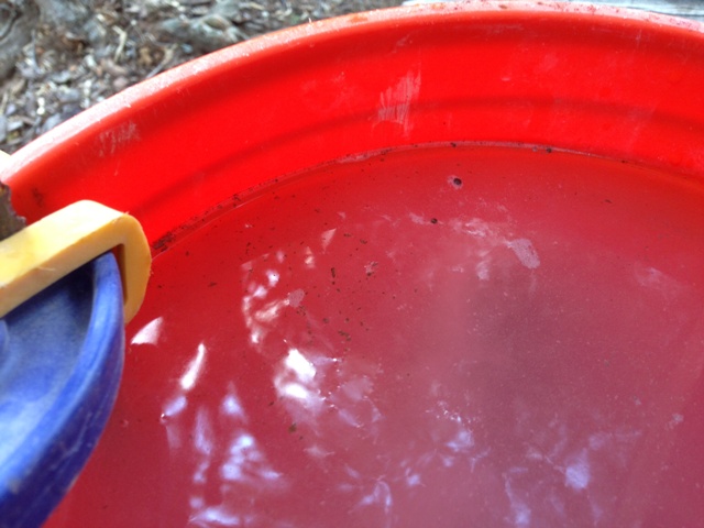

ning-img-0728-9994-53.jpgHard to see but the bubbles are in the middle where the wire goes into the water.
ning-img-0730-9994-11.jpgAfter some time, you will see the specks of rust and some of the old paint coming off the plane and floating to the top.
ning-img-0747-9994-56.jpgHere is the bucket after a few hours of running.
so that is the process and it will strip it down. I will post some pictures when it is finished.

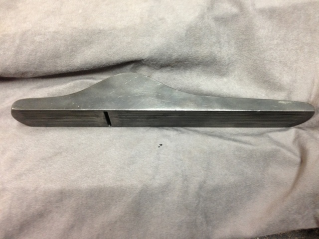

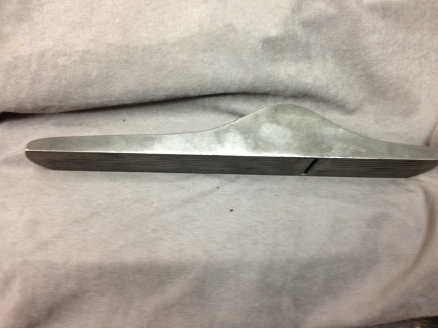

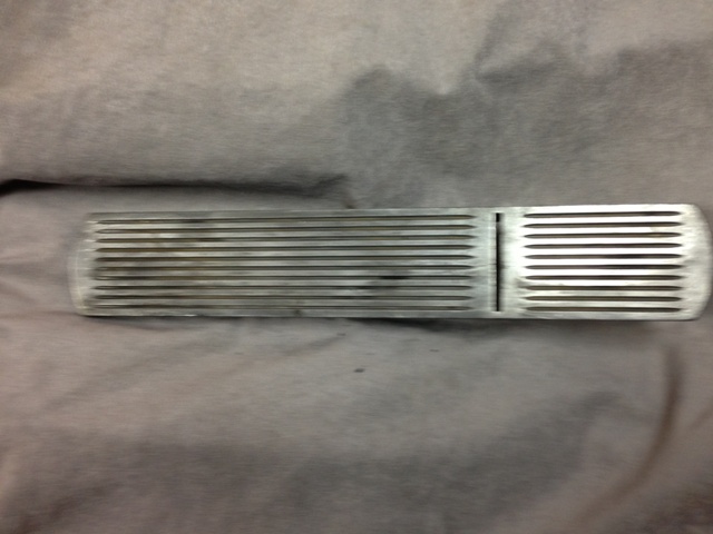

Here are a couple of shots after it was taken out and wiped off.
ning-img-0748-9993-89.jpgning-img-0749-9993-89.jpgning-img-0750-9993-17.jpgning-img-0751-9993-32.jpgDoes a good job and not a lot of labor.
