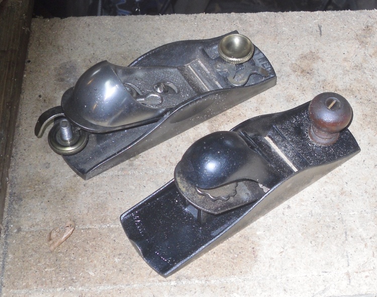

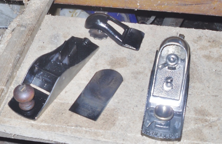

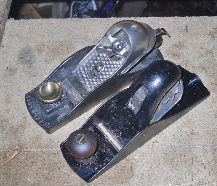

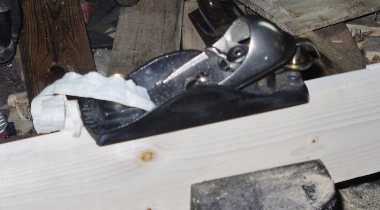

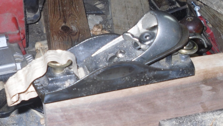

rehab day!   got the Great Neck/ Stanley #9-1/2 all shined up, after wire brushing all that #@@#$# clear-coat off.   Iron was almost sharp, but wasn't square to the sides.   Worked on that for awhile. Rusty Boy needed a LOT of wire wheel/brush work.  The iron was in the shape of a wave across the edge, grinder work along with the other crooked iron.  Had to trudge back upstairs to get  a small tub of water to cool the metal. Then the sandpaper and stones.   Painted the bare metal on Rusty Boy, and allowed it to dry. ning-sdc15750-9627-56.jpg?width=750Brass all shined up, BLO on the wooden knob.  Iron for the now black plane does have the corners back a bit.   A  few more looks at these two?ning-sdc15765-9627-34.jpg?width=750Front views.   Might look a bit more like a plane should?ning-sdc15766-9627-72.jpg?width=750And the back porches.   As for a test drive?ning-sdc15753-9627-33.jpg?width=750GN 9-1/2 on some pine, as a warm up to set the ironning-sdc15759-9627-75.jpg?width=750then  some Black Walnut scraps.

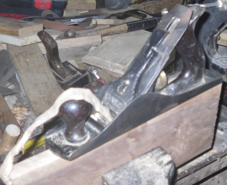

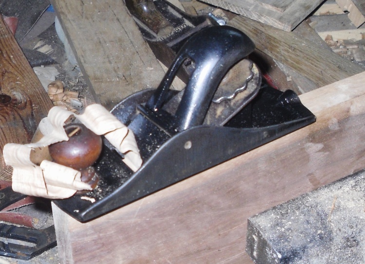

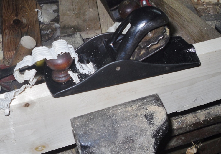

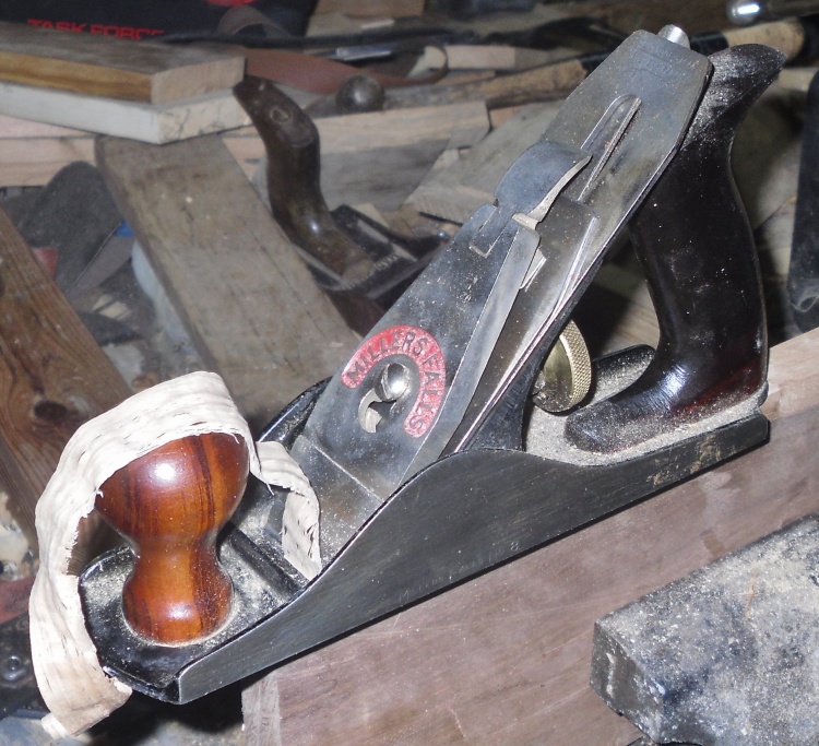

Same with the Rusty Boy, first the warm upning-sdc15754-9627-35.jpg?width=750and then on to the good stuff.  Depth setting for this type of plane is by hammer.ning-sdc15758-9627-76.jpg?width=750Between each plane's trip, leveled the "playing field" with a couple larger planesning-sdc15760-9627-25.jpg?width=750Stanley Four Square Junior Jack,  from the late 1920s.   (No, I did not buy it new..) followed byning-sdc15761-9627-98.jpg?width=750a late 40s Millers Falls #8, which is the same as a Stanley #3 in size.    Just getting a few a work out today...

A red cap was either a stanley one, or a Stanley Handyman/Defiance one.   Iron might have a stamp on it, like a H1220?   "H" is for Handyman Tools.
 have not seen a wheel like on rusty boy.   Most of the other brands I know, but this one is different.    The only red seems to have been the knob, as I found traces of red paint inside the bottom of the knob.    Not too bad a little plane though...
