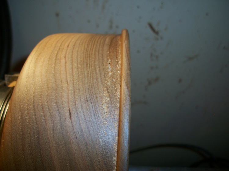

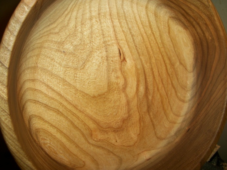

September 9, 201313 yr comment_9364 Didn't get hardly any shop time in this past weekend because I was feelig too sick again. Feeling a bit better today so I decided to get some time on the lathe and seem to have backed myself into a corner. Ok, first, this is a bowl that is made from black cherry. I started on it almost a year ago rough turning it and actually lost the durn thing at the bottom of the wood box thanks to my aid being a bit too helpful Anyway, I finally found it again a few weeks ago. I finished turning it to the thickness desired and am now in the process of trying to sand and finish it. Here's where the problem is. The inside of the bowl has rings around it where the bowl has been sanded. I have sanded it with 80,150,240,320,400,600, Taking a bit extra time with hte 150, because I know you really aren't supposed to skip from 80 all the way to 150, but don't have 100, and no matter what I do, there are still rings even after going through the grits 3 or 4 times now. Also, there is some grain tear out along the rim that just wont go away either, and I am afraid that I am going to turn it too thin if I try to turn that area or sand it until the tearing is gone, so unless someone has another suggestion. I'll probably turn that part away. Here's the dilemma, I don't want to turn it away if I don't have to. If I fill it with CA, it may not stick because of the mineral oil and bees wax I have used to finish it. If it does in fact stick, it wont look right unless I do the entire bottom in CA. Basically I am just looking for ideas that I may not have thought of, and also whether or not you have faced these 2 situations together before, if so how did you fix it. I am very much leaning toward just turning that edge away, trim it down until the tear out is gone. Thanks for your time Charles NichollsSite Hostnicholls61@att.netProud supporter of The Wounded Warrior Project, Homes For Our Troops and the NRAhttp://www.etsy.com/shop/nichollswoodworks Report
September 10, 201313 yr comment_9382 Maybe some of these ideas will help, in the future. For now, I think I'd start the sanding process over again with 80 grit. You'll probably use up more paper than usual because of the wax and oil but you should be able to salvage the complete turning. I've had the same problems, too. Here's what I've been doing to help reduce/eliminate those circles. For the inside of the bowl, I purchased one of these systems- mine is the 3" but they come in 2" models, also-Also purchased all the grits from 80 thru 330. This can be mounted on an electric drill. The other alternative is one of these systems- I haven't tried this style but I am trying to find the materials (round ball magnet) needed to make a handle and use it with the "Wavey" system. Both these pictures were lifted from the Woodcraft site. I really think you should probably get some 100 and 120 grit paper. The jump from 80 to 150 is pretty great and possibly part of the problem. For the outside of the bowl, I get those same marks if my tools are a little dull. Unfortunately, I usually don't realize that fact until I start sanding. What I have begun doing is sanding with 60 or 80 grit until I have sanded out the "white" areas. May take me awhile! Once I get those removed, I go up thru the grits using the Wavey system when possible, or my hand in the areas that are too detailed for the pad. Sometimes, on the outside of a turning, I'll stop the lathe and sand with the grain direction to remove the cross grain scratches that occur from the lathe turning. Hope this give you some ideas. Lew Lew Kauffman-Wood Turners Forum HostTime Traveler and Purveyor of the Universe's Finest Custom Rolling Pins! Report
September 10, 201313 yr comment_9381 your rings are there because your running your sandpaper "Across" the grain of the wood.Notice where the sandpaper was going "With" the grain, there is very little ring showing there.At this point I would take it off the lathe and use a random orbit or a detail sander and go inside the bowl and sand "with" the grain.Same with the outside rim of the wood where the grain seems to have a twist in it and is not sanding the same as the rest of the bowl. Report

September 10, 201313 yr Author comment_9379 Hey there Dragon, loong time no see.I use the sandpaper the same way I have seen every other turner i have watched, with lathe on. THey make no mention of turning the lathe off during any portion of sanding, just sand with lathe on from start to finish.Of course this doesn't mean that they don't turn it off, off camera and just not say so, but since I have nothing else to go by other than what I see, I had no other way of knowing. wouldn't an orbital sander create the same issue. I don't have one anyway but just asking. It's either sand with lathe on or hand sand everything I have no other ways right now.dragon1 said:your rings are there because your running your sandpaper "Across" the grain of the wood.Notice where the sandpaper was going "With" the grain, there is very little ring showing there.At this point I would take it off the lathe and use a random orbit or a detail sander and go inside the bowl and sand "with" the grain.Same with the outside rim of the wood where the grain seems to have a twist in it and is not sanding the same as the rest of the bowl. Report
September 10, 201313 yr comment_9378 Charles,I sand all my rolling pins with the random orbital sander. At about 180 grit, I turn off the lathe and sand lengthwise along the pin. Those two processes eliminate all scratches. Of course, a bowl is a totally different animal! As Dragon1 pointed out, it's almost impossible to remove all of the scratches using hand sanding and the lathe spinning.Charles Nicholls said:Hey there Dragon, loong time no see.I use the sandpaper the same way I have seen every other turner i have watched, with lathe on. THey make no mention of turning the lathe off during any portion of sanding, just sand with lathe on from start to finish.Of course this doesn't mean that they don't turn it off, off camera and just not say so, but since I have nothing else to go by other than what I see, I had no other way of knowing. wouldn't an orbital sander create the same issue. I don't have one anyway but just asking. It's either sand with lathe on or hand sand everything I have no other ways right now.dragon1 said:Charles NichollsSite Hostnicholls61@att.netProud supporter of The Wounded Warrior Project, Homes For Our Troops and the NRAhttp://www.etsy.com/shop/nichollswoodworks Report
