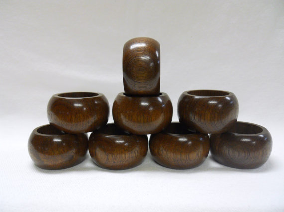

I started on pens myself but you can basically start wherever you feel comfortable, here's an idea for a first project, make a set of Napkin rings, it's repetitive and would teach rounding of a bead well.
These are not mine but they are a great example. ning-napkinrings-9279-53.jpg
These have about a 1 1/4" hole drilled in them but you can make them smaller.
Just a idea :)

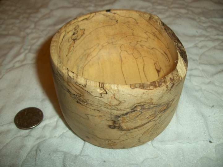

Also, before starting, make sure there is no loose bark on the spindle (they do hurt when they hit ya) and no major cracks in the wood. I made the mistake once (I think I showed it here.) of not checking a bowl blank thoroughly, a piece came off the blank and slapped me in the face, I didn't have a face shield only goggles. Luckily slapping me instead of digging in as it was pretty much wedge shaped, kinda like a skinning blade.
Yea here it is, pretty much completed at this point but the sloped edge is what was left after the piece came loose :)
ning-000-0007-9275-54.jpg?width=721This incident right here taught me that there is no place for only wearing goggles when wood turning when you can go buy a $15 face shield and be 100x better off.
