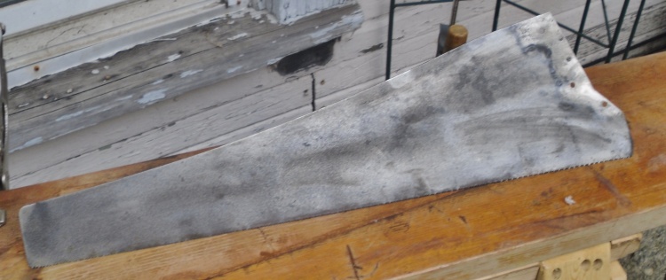

September 12, 201313 yr comment_9217 Some of which were getting very rusty.   A Plymouth Rock saw plate was first to be sanded cleanHandle looks like it was made by Atkins, while th shined up brass say Pheonix WarrantedHandle has seen better days, though. A look at the entire saw?Nice long skew back 9 pointer. Etch will need some "gun blue" to bring it out better.  As for the next saw, cleaned the plate like the first saw.  Then stripped the finish (was in BAD shape) off the handle. Sanded smooth again, and a wipe-on/wipe-off coat of that smelly BLO stuff. Also shined the brass. it is on the right of the picture. Again, a Atkins tote, and a Pheonix Warranted medallion. But, look a little closer, down near the toe.....a nib!   Haven't found any etch...yet.  Had to move them inside the house, as a thunderstorm was getting lose by.  That "other saw" you might know, another look?Two shew backed saws, and a saw.    Last saw of the day needed the hardware cleaned up, as the rest wasn't too badMy one dollar, 10 point panel saw.  Steel hardware needed a shine.  Plate had already been cleaned a few days ago.  Still have maybe six more to clean up.  Due to the rain going on around these parts, went dumpster diving instead.  Found a few items, enough to build a workbench with..... Planer? I'm the 'planer', and these are what I use... Report
September 12, 201313 yr Author comment_9224 Lets see, a palm sander with 120 grit paper on board, followed by a metal polish and steel wool.  Tried to do that by hand, then just chucked the steel wool under the sander and pressed down ....hard.   Other side of the first saw was worse, rust wiseRust still looked like freckles.  Clamped a 2x10 onto the new saw bench.  Didn't want to get rusty dirt on the new bench, right?   Might refinish the tote on this one, as well.   The second saw, with a nib, is a 7 pointer.  So now, these four saws range from a 5 pointer (D-8) through a 7 pointer (nib) a 9 pointer (Plymouth Rock) to a WS saw aat 10 points. Nice spread.. Planer? I'm the 'planer', and these are what I use... Report
