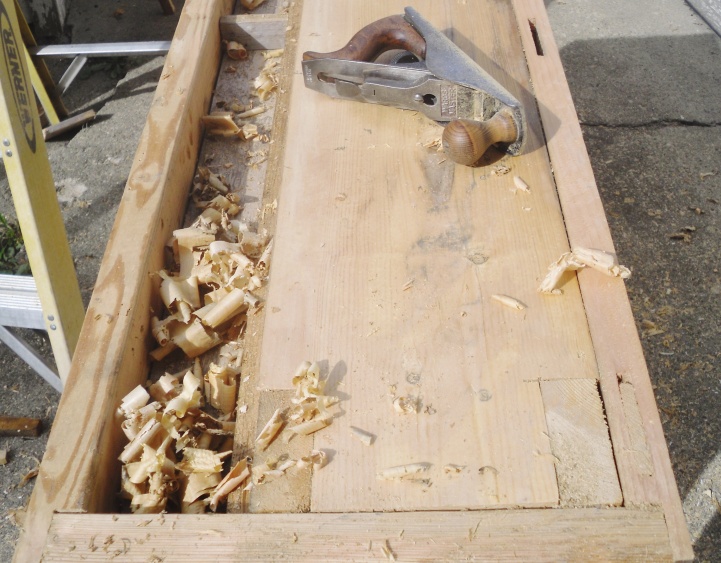

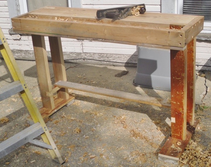

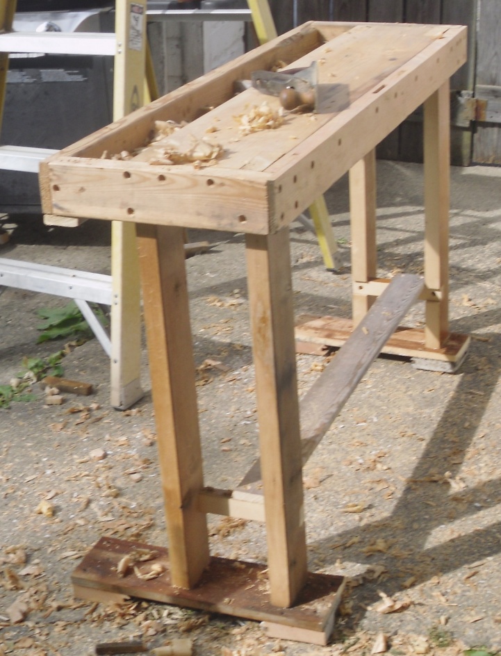

September 16, 201313 yr Author comment_9110 Just a look-see at what good done in about six hours today, Counting the hour it took for the wife to go and get a box of 2" screws( Lunch break??)Hey, it may not be fine furniture, but seems to be about right for some hard workIt even has a toolwell, tooeven managed to somwhow get the top flatAll done on the back patio, on a nice Sunday afternoon.  Not too bad for Dumpster wood, is it now??? Planer? I'm the 'planer', and these are what I use... Planer? I'm the 'planer', and these are what I use... Report

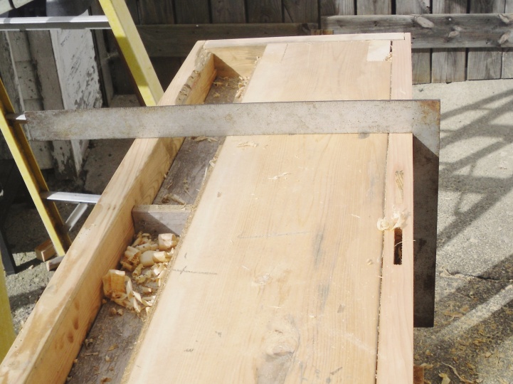

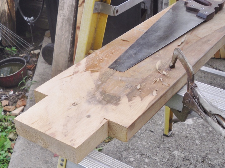

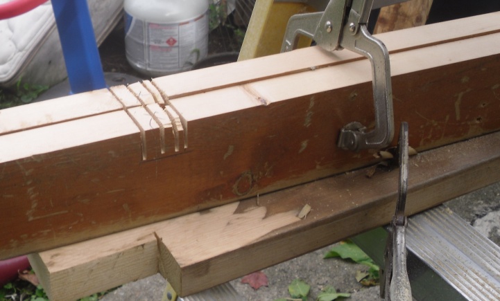

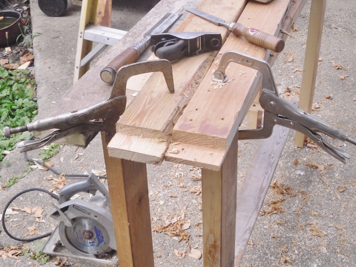

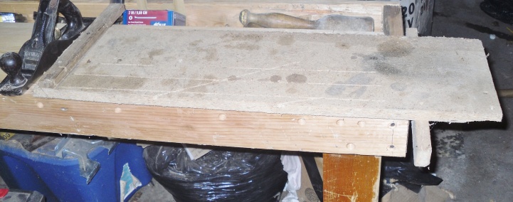

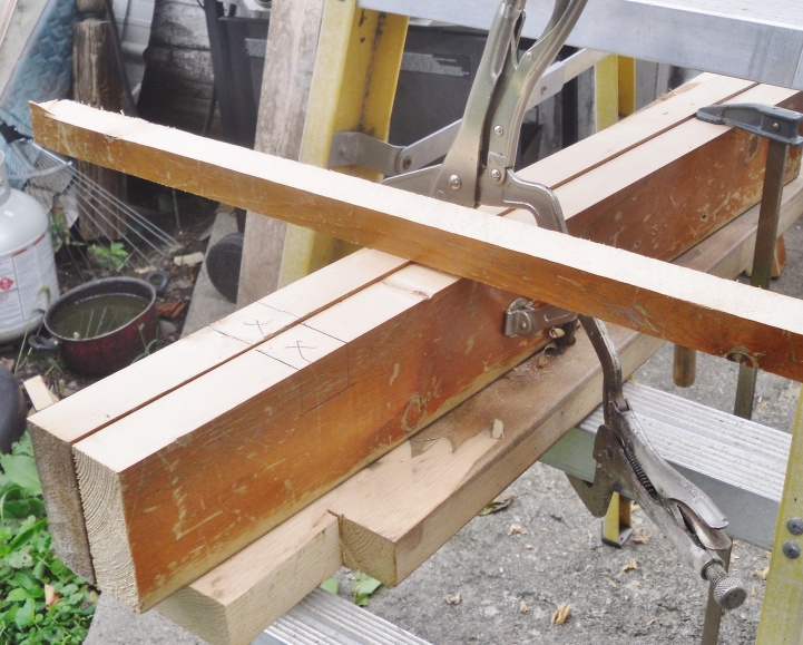

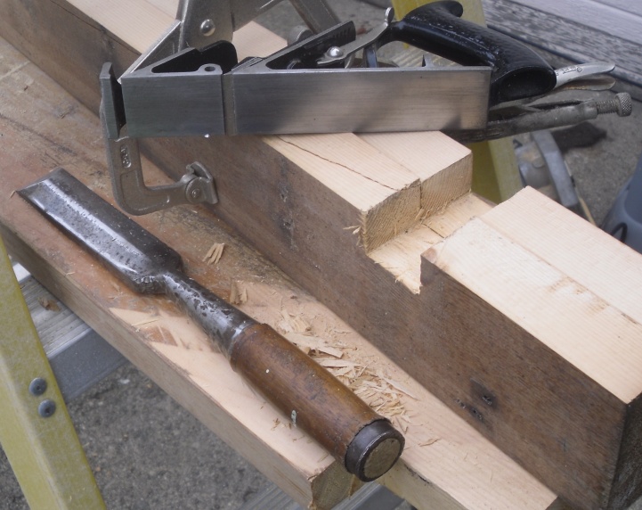

September 16, 201313 yr Author comment_9109 Just a few more photos of this little projectA circular saw did most of the work, finished to cuts with that handsaw.  Planed the end, to better lay the joints out. Two legs, and some layout work. The piece laying across the legs will become a brace between the legs.  Ripped two legs from a 2x10, the strip laying there was leftover.  Saved it for the leg braces. Once the lines were drawn, time to cut things upand then knock the waste out, a little clean up was nextAlittle chisel took the chunks out, and a bit of paring work. Had to remove the fence and depth stop on the 78, then it fit the slot. as for the aprons.  Front one is a 5/4 x3-1/2 , and the rest were 2x4s Ends of the long pieces needed some joinery done to themThis is after the legs were fitted.  A stretcher was added to the legs braces.  Lots of screws were needed, too. Had to take a break, while the better half went to get some 2" screws.  Wallyworld was out so she went to Lowes.  Had to pay three times walyworld's price....Once the aprons were attached, tried to get the top and the legs and the aprons to be flat.  Lots of handplane work... Planer? I'm the 'planer', and these are what I use... Report

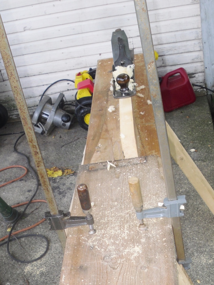

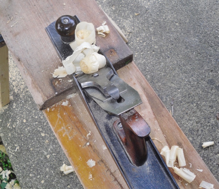

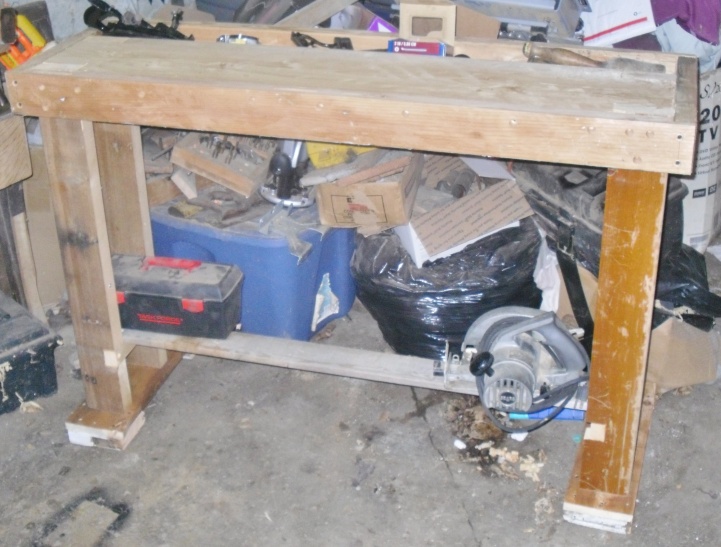

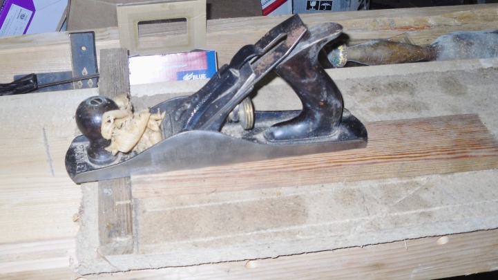

September 16, 201313 yr Author comment_9107 Got the bench down to the Dungeon Shopnow the shop is in the shape of a "U".  Tried out a jig on the benchand just had to try it outPart of building the bench was making the legs.. Ripped them out of a 2x10.   That left saw marks on the legs.   clamped a piece of wood to the saw benchand placed a leg against the "stop".  Grabbed a #6 small jointer, and made a shaing or twoand soon had Gossemer Shavings floating across my back yard.  Just wouldn't be proper to have legs with saw marks showing, now would it? Planer? I'm the 'planer', and these are what I use... Report
