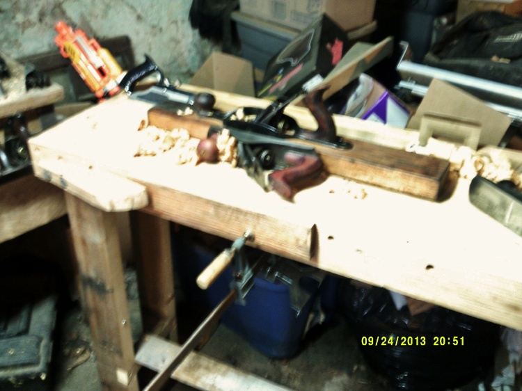

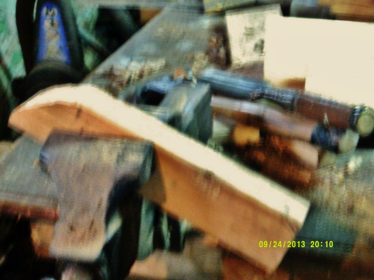

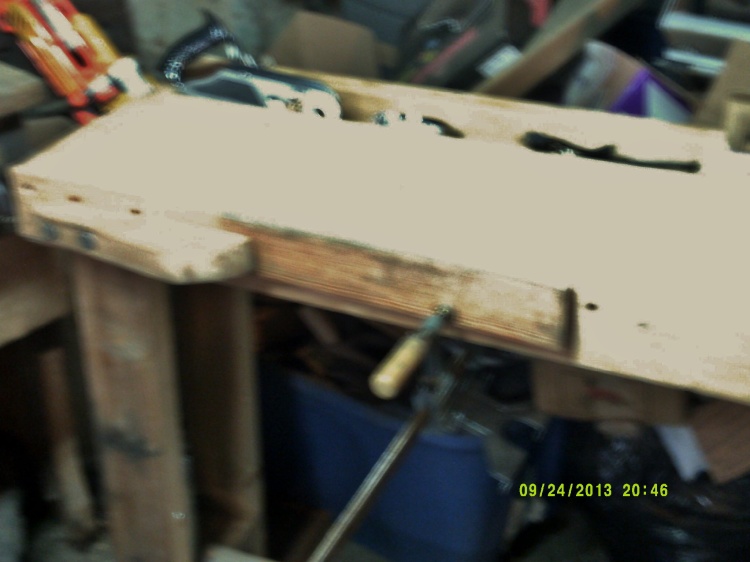

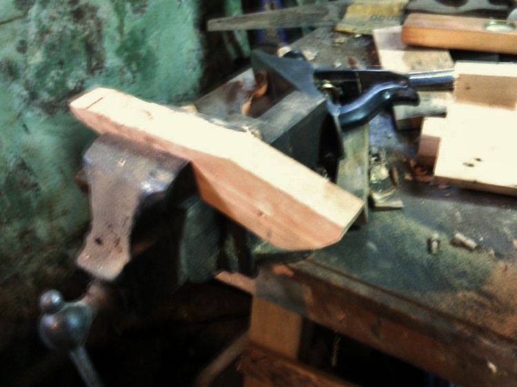

September 25, 201313 yr comment_8721 No, not something one knits. It is a hook-like item on the side of a bench.   One then jambs a piece of stock into the hook until it is wedged in place, and clamps the free end in place.   Until a proper vise is bought, one of these will just have to do. Started out with a chunk of Sycamore scrap, 5/4 x4" x 12".  Shaped one end into a rounded sort of pointthere's them fuzzy pictures again. Anyway, a coping saw proved it wasn't up to the task, so a BIG chisel and a BIG hammer did most of the work.  Beltsander then sanded it smooth. Which left the area that will go against the side of the bench. Tried a ripsaw, did like how it was going.  Finished it off with those big tools, again. Then a plane , or two to smooth the chisel tracks off.this is before the planes went to work on it.  Wound up working over both flat areas, to widen the size of stock I could clamp up.  Forstner bit to relieve for two lag screws, and then two smaller drill bits to make hole for the lags.  Ratchet and socket to tighten things in place.  Lags go through the apron, then through the leg. they show up as two blue dots.   Had a piece of barn wood that need an edge planed straight, aka jointed. So, a clamp and a mallet to secure the piece, and away we go. not too bad? Now,IF I can just figure out the focus on this new camera-ooski..... Planer? I'm the 'planer', and these are what I use... Report

September 27, 201313 yr comment_8723 Hey steve, that's also what they used on the top of the bench to hold wood down, similar to using dogs and wedges. Report
