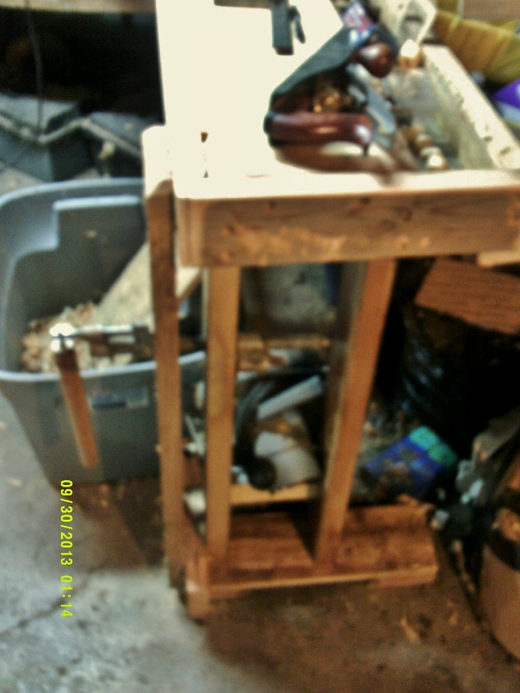

October 1, 201313 yr comment_8591 New workbench got an older leg vise yesterdayStopped at the old Pole Barn Shop, and picked up this "gem". Used to be on the English Bench I built a while ago. With the feet sticking out on the new bench, leg was just a bit long, soclamped it down and sawed the excess off.  Needed a hole to mount the pipe part of the vise, soForstner bit in an electric drill.  Mounted the vise in the hole.By adding a spacer at the bottom, and the other end of the pipe clamp on the other side of the leg.  Screw on the vise is run all the way out. I can slide it as needed by adjusting the inside part.   Then I have at least 2" of screw travel. As viewed from the side. Planes were used to finesse the top edge of the "chop" as it is called.This Junior jack did a nice job on end grain.  The WR #4 V3 smooth things level, as well. Not much in the way of "fancy", but should work.. Planer? I'm the 'planer', and these are what I use... Report
