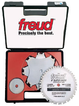

October 6, 201313 yr comment_8470 you can put on smaller diameter blades. Dados are typically 3/4" or less in depth so you do not need a larger blade. Also the smaller the blade the less weight that has to be spun by your saw motor. Most of your good quality dado sets will come in 6" or 8" in diamter. I have a Jet Contractor and the Freud Super Dado 8" set and it works just fine. Just be sure to get the best quality set that you can afford. Allen WorshamCorona, CAallenworsham@earthlink.net'Graze in every man's field, but always give your own milk.' J. Vernon McGee“Our greatest fear should not be that we won’t succeed, but that we will succeed at something that doesn’t matter.†D.L. Moody Report

October 7, 201313 yr comment_8461 I have the 8" Freud set Ron, I hate it. I don't like the "Cutting Edge" design, and it was the worse investment I have ever made, get a traditional dado set, and yes, 8" will do well on your 10" table saw. John MorrisThe Patriot Woodworker Report

October 9, 201313 yr comment_8459 John, Which dado set do you have from Freud?I have the Freud Super Dado 8" set and could not be more pleased with it. It has the 4 wing chippers in different thicknesses for precision fit and the various shims to deal deal with under/oversized dados. It was definitely pricey but worth every penny. John Morris said: I have the 8" Freud set Ron, I hate it. I don't like the "Cutting Edge" design, and it was the worse investment I have ever made, get a traditional dado set, and yes, 8" will do well on your 10" table saw. John MorrisThe Patriot Woodworker Report
October 9, 201313 yr comment_8458 Mine is similar Allen, except I have the two wing chippers.It feels like I have to really push the material through it and the cut is less than flat, very rigidity. I need to clean up the bottoms with my rebate plane every single time or the joint looks jagged. Perhaps the 4 wing chippers are an improvement.Allen Worsham said: John, Which dado set do you have from Freud?I have the Freud Super Dado 8" set and could not be more pleased with it. It has the 4 wing chippers in different thicknesses for precision fit and the various shims to deal deal with under/oversized dados. It was definitely pricey but worth every penny. John Morris said: Allen WorshamCorona, CAallenworsham@earthlink.net'Graze in every man's field, but always give your own milk.' J. Vernon McGee“Our greatest fear should not be that we won’t succeed, but that we will succeed at something that doesn’t matter.†D.L. Moody John MorrisThe Patriot Woodworker Report
