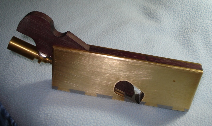

October 24, 201313 yr comment_8050 I made this one from Shop Notes Lew Kauffman-Wood Turners Forum HostTime Traveler and Purveyor of the Universe's Finest Custom Rolling Pins! Report

October 24, 201313 yr comment_8048 It was No. 88. Here's a link to a little more info-http://www.shopnotes.com/issues/088/sources/dovetailed-shoulder-plane/Gene Howe said:I'm not sure about the angle either, John. I sharpen my chisels ar 25 deg. I figure that I want that bevel to lay flat, or to be level with the base of the plane. I did some searching but found nothing definitive. Lew. That's a fine looking plane, there. Beyond my abilities, I fear. What issue of shopnotes? Gene'The true soldier fights not because he hates what is in front of him, but because he loves what is behind him.' G. K. Chesterton Report

October 24, 201313 yr comment_8046 Lew, that is absolutely awesome!!!!!! What a cool plane and nice project, fine job sir, fine job indeed, how does it work? Good, fine, so so?Lewis Kauffman said: I made this one from Shop Notes Lew Kauffman-Wood Turners Forum HostTime Traveler and Purveyor of the Universe's Finest Custom Rolling Pins! John MorrisThe Patriot Woodworker Report

October 24, 201313 yr comment_8044 It works pretty good, John, although it is not the most comfortable design when it's in your hand.John Morris said: Lew, that is absolutely awesome!!!!!! What a cool plane and nice project, fine job sir, fine job indeed, how does it work? Good, fine, so so?Lewis Kauffman said: John MorrisThe Patriot Woodworker Report
