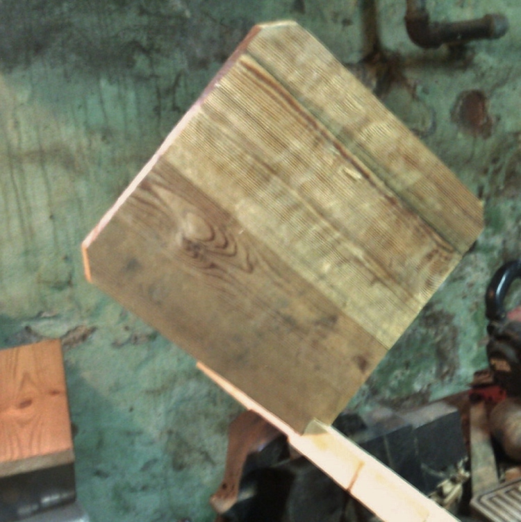

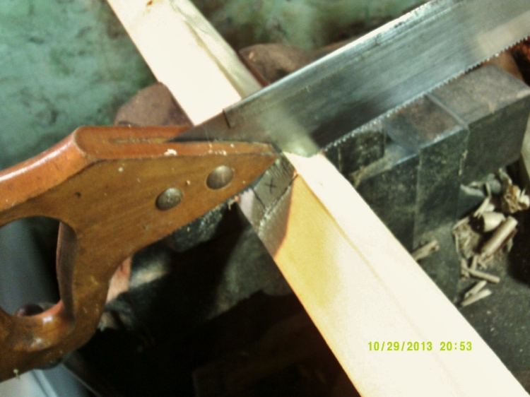

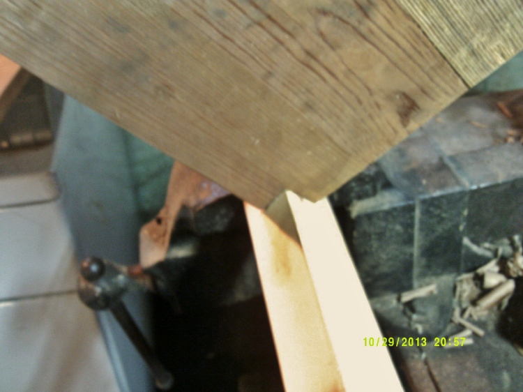

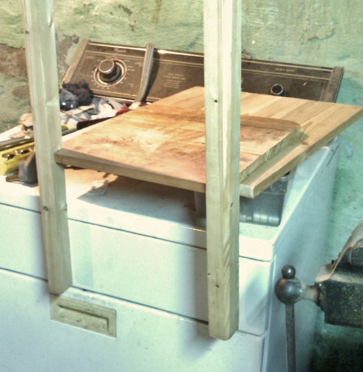

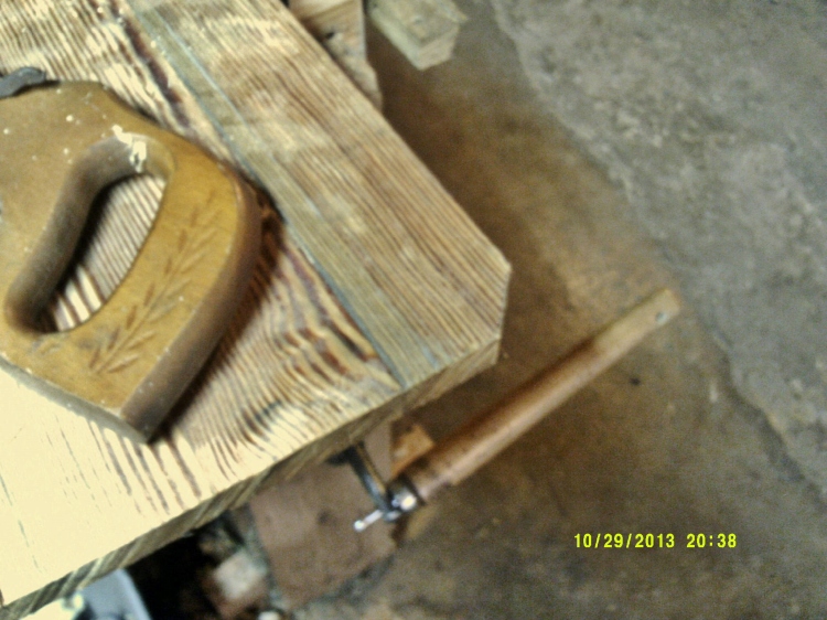

Working on the shelf and legs. Had to clip the corners off the shelf, to fit into notches on the legs.  Ran a saw across the legs about halfway up from the bottom of each leg.   Two saw cuts, and then a little bit of chisel work to remove and pare each notchning-dscf0042-7843-25.jpg?width=750.  Pictures are getting in the wrong order, for some reason.  Anyway, tried a few test fits along the wayning-dscf0043-7843-63.jpg?width=750The old dryer is a set-up table/storage area now.  these twi are just hanging on.  Outside corners on each leg have been champfered  to the size of a screwhead, using a handplane or two.  Next up, sizing a top for this little thing.ning-dscf0040-7843-49.jpg?width=750ning-dscf0041-7843-46.jpg?width=750ning-dscf0032-7843-13.jpg?width=750
That should create a very stable table. Love the grain in that shelf, too!
