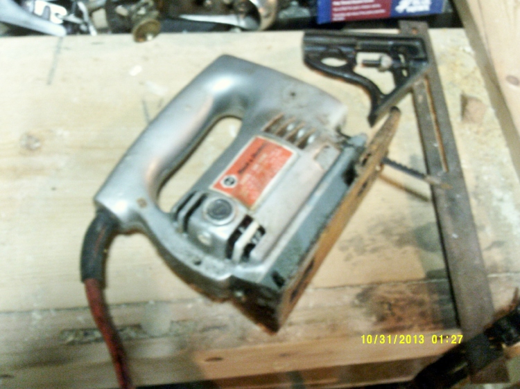

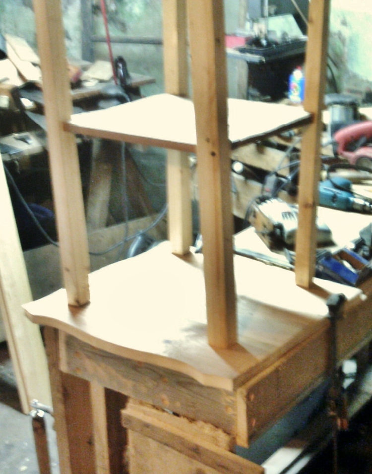

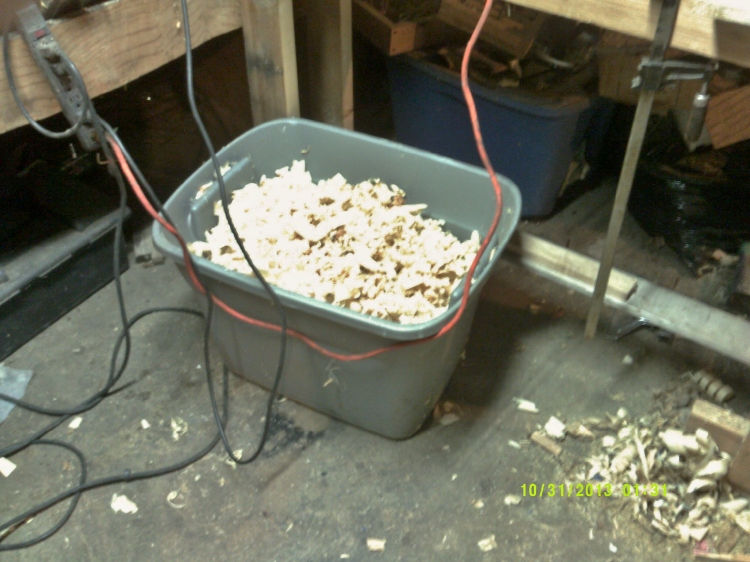

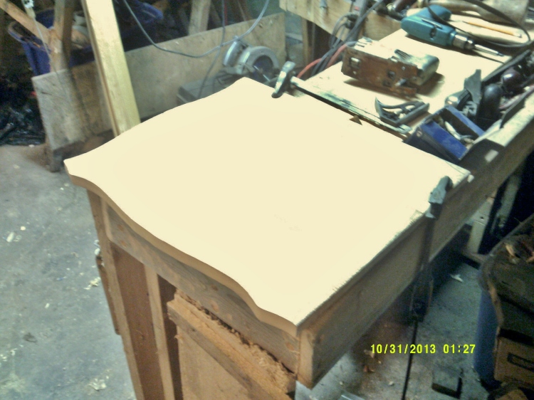

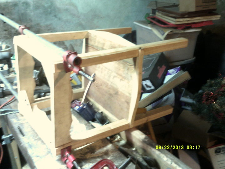

November 1, 201313 yr comment_7840 Try this again. Something about the way the photos are loading.   Anyway, dug out a sabresaw that I found at my Daughter's new apartment.  Was going to give it a workout on the top's edges.  Had the legs all done, even a pilot hole for some screws. Used an old apron pattern to lay out the edge of the top. Clamped the top to the bench, and sawed two edges. Then rotate the top, and saw the other two.  Cleaned up the saw marks with a beltsander, as I don't have the right type of plane.  Still have to cut the aprons to the correct sizes, tenon them, and install. That will be next time.. BTW, handplane work does make a big pile of shavings, don't it? Planer? I'm the 'planer', and these are what I use... Report

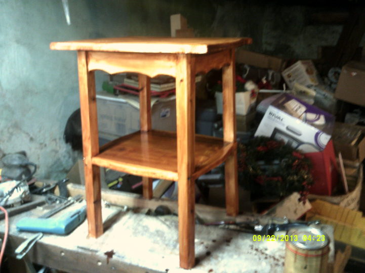

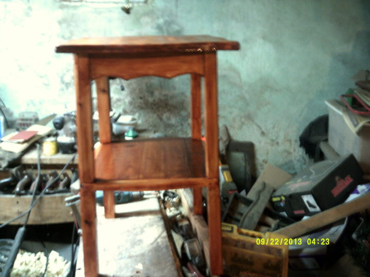

November 12, 201313 yr Author comment_7841 Might have this little table about doneglue up, and install some corner blocksend view.  Not sure which is front or sides on this one, almost square.  Just a small pine table.  The "Other Half" has already table-napped it as a night stand... Planer? I'm the 'planer', and these are what I use... Report
