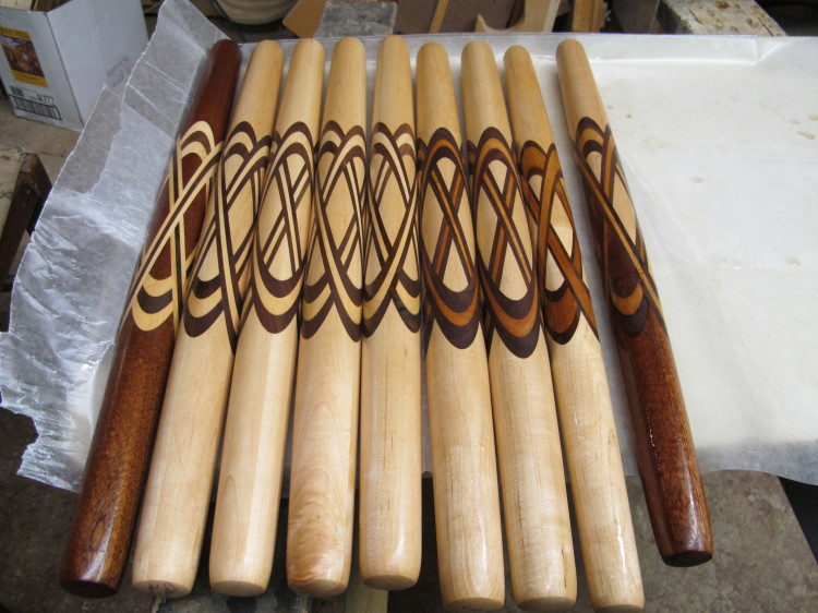

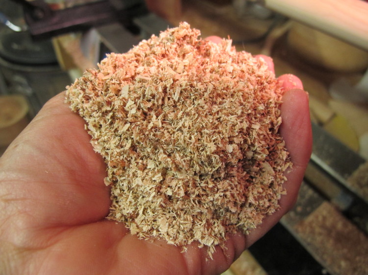

November 6, 201313 yr comment_7749 Here it is Wednesday again! Got a little turning and finishing done this past week. First, finished up a batch of rolling pins that had been glued up and waiting for quite a while. Sanded and applied a couple of coats of Mineral Oil.  When I make these, I sand them thru 320 grit and the burnish them with the turning shavings. It is amazing to watch the already smooth surface take on a sheen. I’m not sure what would be a comparable sanding grit but it sure is cheaper than using those micro grit foam finishing pads.   I tried to take a video of this but it is not really as dramatic as watching it happen in person. Report

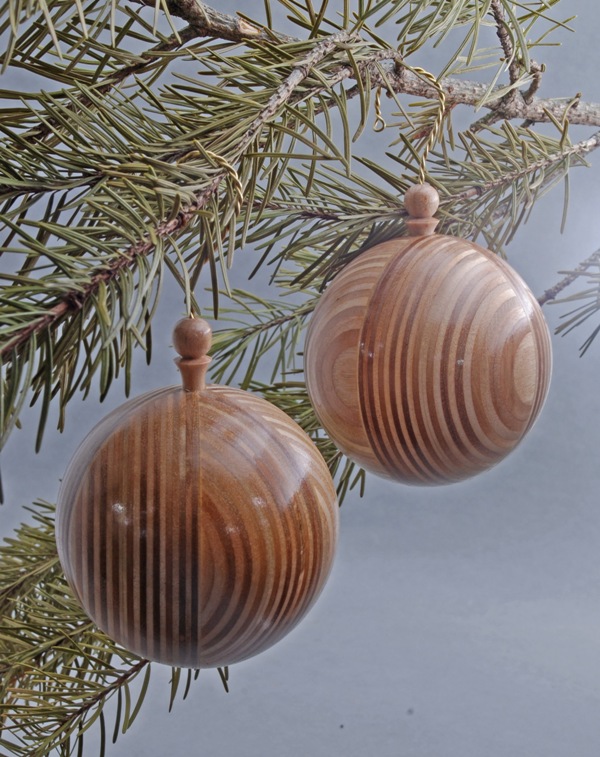

November 6, 201313 yr Author comment_7751 Not sure what I did wrong but I can't get the remainder of this post to show above. SO- ******************************************************** Also received a newsletter from David Reed Smith on turning a Christmas Ornament. http://www.davidreedsmith.com/Articles/SphereOrnament/SphereOrnament.htm  Looks pretty cool! Safe Turning! ******************************************************************************** End of addition Lew Kauffman-Wood Turners Forum HostTime Traveler and Purveyor of the Universe's Finest Custom Rolling Pins! Report
November 6, 201313 yr comment_7750 These are awsome. Think I need to learn how to make one or two. Let me know how much you sell these for and I'll buy one so I can learn. (especially) if I can have some instructions.Dennis Report
