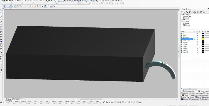

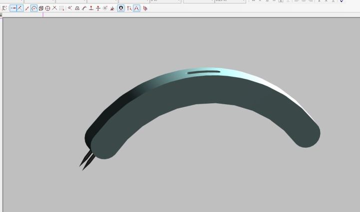

November 19, 201313 yr comment_7615 The router bridge is the fastest, but will leave plenty of tool marks to sand away. Whether the base stock is uneven or not you can use screws from the back in parts that will be cut away to lock it down ot make little dogs with teeth to clamp the work down in choice locations pulling or down on the high points to prevent warping of just shim it. A hold down dog like this can clamp from the edges where the router cutter can't contact Report
