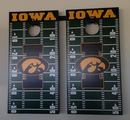

June 4, 201412 yr comment_7356 What kind of wood did you make them out of? I made a pair for my Son In Law with 3/4" plywood for the tops. I then sprayed three coats of Rustoleum dark green on the tops. Green because he added vinyl decals of the University Of Iowa football field on the tops. I can post images of them if you like. For the undersides and legs, exterior grade latex flat black. Larry Report
