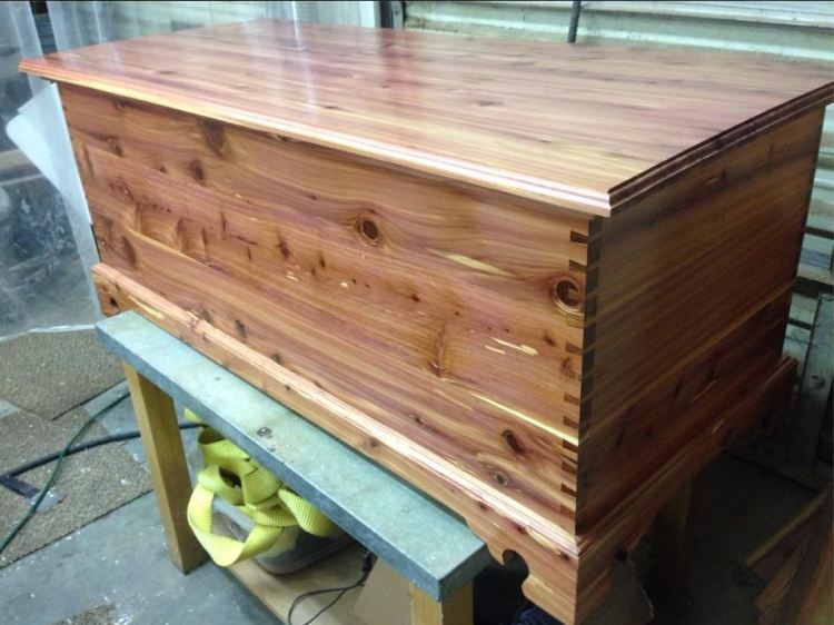

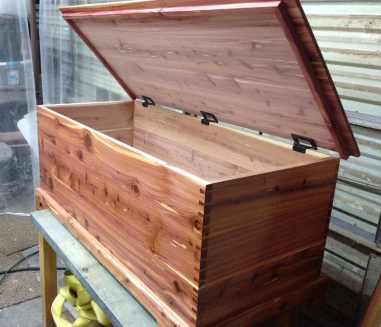

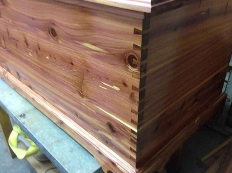

Well I have had this on the bench for a while but it is finally finished and will be picked up tonight.
ning-cedarchestfinished1-6464-44.jpg?widning-cedarchestfinished2-6464-34.jpg?widning-cedarchestfinished3-6464-4.jpg?widtFour coats of Blonde Shellac and four coats of General Finishes Enduro Var. Inside has no finish, just that wonderful cedar smell.

Looks good. I haven't ventured into the land of dovetails yet but I know it's something I need to try.
You do a great job on those cedar chests. Very nice work.
My wife saw it on FB so now she is asking if I have thought of making some of those. Thanks Moody. :-(

I can smell it from here!! Beautiful!

John, that looks just flippin outstanding!!!! The DT Jig, which one you using? The Keller series, PC long one, I need to get me a jig that can do the entire run of DT's, I have the Keller 16 inch and I need to rout my work, then carefullly mark  it, and move the jig down the line. A DT machine would be a welcome addition to my shop!
Are you putting some baker blocking behind that scrolled skirt work at the bottom? One good whack with a vaccum that pointy piece fly's off. I like to put a backer piece the same shape at the scroll work. I learned that trick when following some plans for a blanket chest in American Woodworker Mag.

Thanks everyone. It did take me forever to finish but I had a customer pick it up after the first one backed out.
John I will have to look up the name of this jog. It is 15" long but you can add 15" sections to make it as long as you want. I purchased one year when the Woodworking Shows came close to us. It is really simple to use and is fast to setup.
The cedar smell was just awesome. I gave the inside a fresh sanding just before they picked it up so it was smelling good.

Oh that's very nice.  Did the routering give you any worry when you  hit that knot in the DTs?
Yes, but I took it slow and gave it time to cut slowly.
