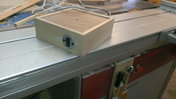

degaussing ring almost done

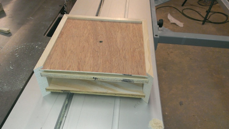

About 800 feet of #24 gauge enamel coated copper wire wound between two boards of ply one was 1/8" thick on a little round turned piece about 2" diameter by 1/4" thick.
I clamped it on my lathe attached a face plate to the other end of the head stock and attached a handle to that and manually wound it.  Took maybe half an hour.
Then I  installed a switch a  power cord and a terminal block to hook things to and VIOLA When I  Run my calipers pliers whatever across it it buzzes mightily and demagnetizes  my tools.
 The pic is pre-glue up I'm just try fitting. You can see the construction from the side where I have not got the fourth mitered side on

The actual ring on this is a quarter inch thick dish of windings about 6.5 inches in diameter.

ning-degausser-6281-50.jpg?width=721

oh the hole  was how I held it on the lathe and clamped the center mandtil to the pieces of ply. Now it's just decorative.
Run the steel piece across the surface and Presto Chango  Abracadabra and  POOF the magnet fairy grants your wish.
