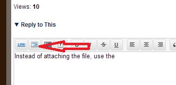

January 1, 201412 yr comment_6249 Instead of attaching the file, use the little picture button to the rite of the word Link You can upload your pictures into the post. Lew Kauffman-Wood Turners Forum HostTime Traveler and Purveyor of the Universe's Finest Custom Rolling Pins! Report
