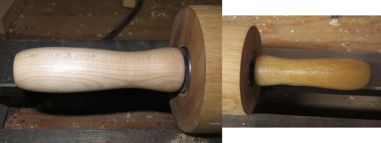

During my time in the classroom, yesterday, an administrator showed up with a rolling pin in hand. I wasn't sure what I had done to deserve that punishment! Turns out, one of the students in the Culinary Arts program dropped the pin on the floor and split one of the handles. Instead of beating me with the pin, they just wanted me to make a new handle.
Replacement on left- original on rite
ning-untitled1-5865-28.jpg?width=750
The pin looks like it was made from Beech but all I had similar was Maple. It not the same but pretty close.

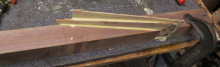

Other than that, I'm still working on getting rolling pin blanks made. It only takes about 7-8 minutes to turn a square blank into the rolling pin but the amount of time leading up to that point is considerable.

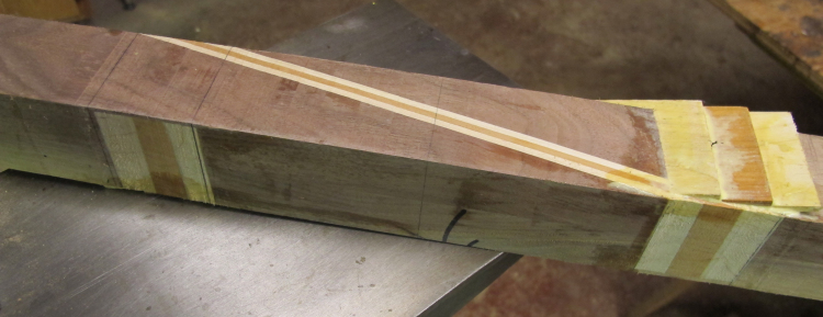

After milling the inserts and pin blank, you start here with the slot
ning-img-2938crop-5865-20.jpg?width=750

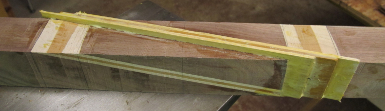

Then apply a liberal coating of glue to the slot and inserts-
ning-img-2939crop-5865-16.jpg?width=750

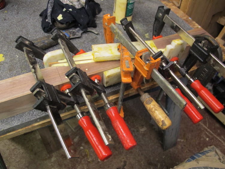

Press the inserts down into the slot and clamp the bejesus out of it-
ning-img-2940-5865-41.jpg?width=750
Wait for about an hour , remove the clamps, cleanup the glue squeeze out-
ning-img-2941crop-5865-4.jpg?width=750

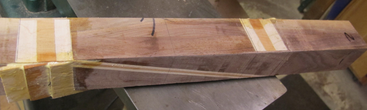

Wait another half hour or so to allow the wetness of the remaining glue to dry up enough so it will lessen the transfer to the bandsaw table and blade. Trim the excess off of the inserts flush with the blank- (this one is in the half hour wait cycle)
ning-img-2942crop-5865-95.jpg?width=750

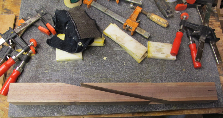

Flip the blank to the next side and back to the table saw to cut the next slot-
ning-img-2943crop-5865-50.jpg?width=750
So, all in all, it takes just south of 2 hours to get each one of the 4 sides of the rolling pin ready for turning. Of course, most of that is waiting for the glue to dry. I could speed things up if I had more clamps. I got a birthday coming up!
