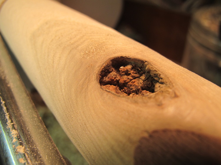

Happily turning away, the blank went from square to round. From thump, thump, thump to the smooth “shushing†sound of the gouge making contact on the entire surface- except for one spot! Power off, lathe spins down and there, exposed, was-
ning-img-2976-5682-61.jpg?width=750
ning-img-2972-5682-43.jpg?width=750
At first, I thought it was a nail or a bullet embedded in the wood but the metal detector failed to detected anything. Naval training provided ample and appropriate vocabulary for the situation. I needed to make a chisel handle anyway, just hadn't figured on it being that fancy.

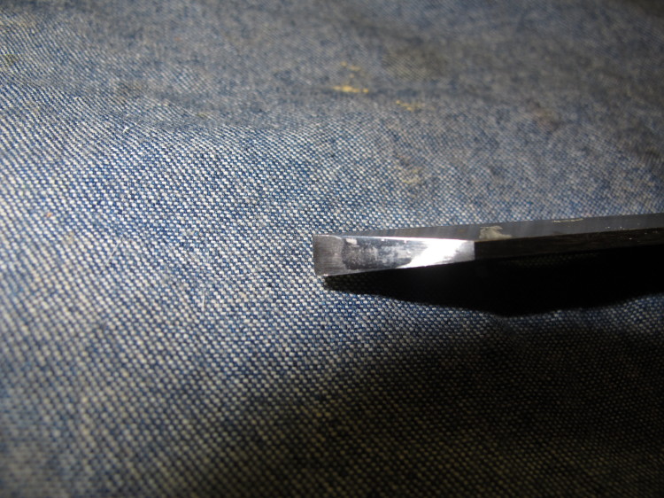

While waiting for the glue ups to dry, I spent a few minutes making a thin parting tool. The one that has been my go to tool is fine; it is just a little wide for some smaller projects.

Cap’n Eddie has a Youtube video on making one of these from Weed Whacker blade- OK, I’m cheap and didn't want to buy one. Looking around the shop, I found an old butcher knife. It was removed from service when I made a new one. The Dremel Tool and a cutoff wheel made short work of shortening the blade.
ning-img-2959-5682-24.jpg?width=750
ning-img-2961-5682-42.jpg?width=750
Then the bench grinder to reshape the metal
ning-img-2954-5682-76.jpg?width=750
Comparing the two tool cutting ends
ning-img-2962-5682-11.jpg?width=750
The knife was stainless steel so I’m not sure how well the edge will hold up between sharpening.

I like the knife parting tool. I made one a few years ago. I didn't do as much as you did. I just slanted the end of the knife and tapered it a bit. It works great to get into those tight spots.

Really liked what you did with the knife. Never thought of that or would have. Capt. Eddie is fun to watch and I'm betting he has a low cost solution to most anything. I enjoy watching his shows.

What about filling the hole with clear epoxy or acrylic? It might change the turning dynamics, but if you could get the final polish to come out clear, that seems like it would be a neat 3D effect.
Thanks, John! That's an interesting possibility!
