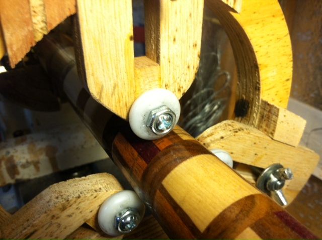

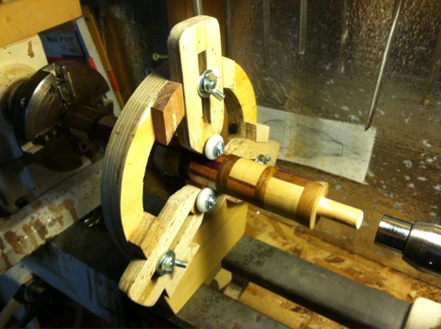

Thanks to you guys for the suggestions on roller replacements. I ended out getting 4 bathtub door rollers. Thet were $4 and the right size. Shower door rollers had plastic on the center shaft and I figured the heat would damage the plastic.  I drilled out the threads and used a wood screw to attach them. I made sure the screw threads ended and the aluminum wheel had a smooth surface to roll around.
 I tried it out this morning and it seems to do the job OK. The real test will be how they do after continued use.
  • 1 month later...
Inline skate wheels work great.  You can buy used skates at Goodwill really cheap and just rob the wheels off of them.  They have center bearings.
