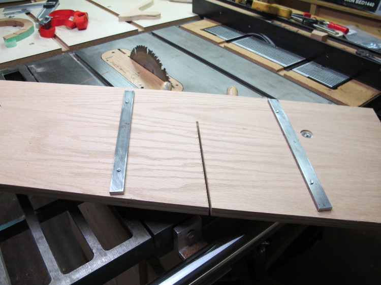

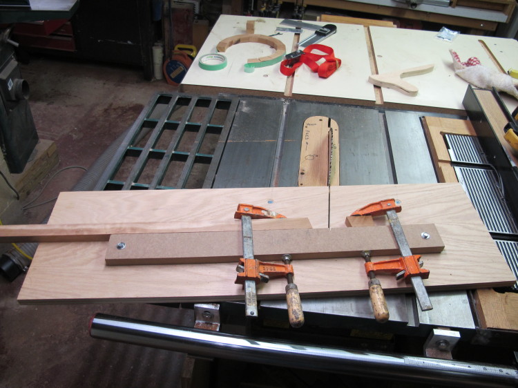

So, to stay busy, I am working on a sled to cut angled pieces for segmented turnings. Cap'n Eddie has a nice little video for making the sled- https://www.youtube.com/watch?v=it64J6UB0XM.
I took a few liberties on mine. Specifically, I used metal runners and borrowed an idea from Frank Howarth on how to place the plywood sled base for greater material support- https://www.youtube.com/watch?v=UGpD-ZNjZ4I His miter sled will be my next makeover!
My sled-
ning-img-2997-5289-53.jpg?width=750
ning-img-3011-5289-81.jpg?width=750

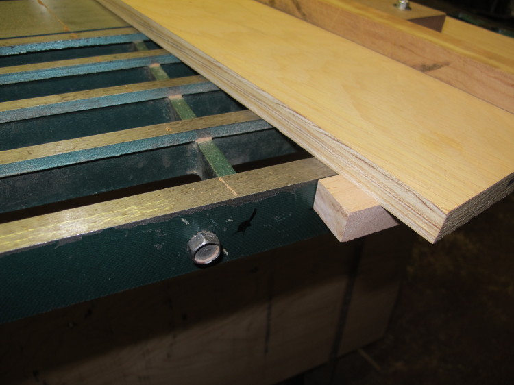

It seems like every sled I build ends up getting pushed farther and farther into the saw blade over time. To prevent this, I am adding stops to the sleds.
ning-img-3004-5289-84.jpg?width=750
It's just a large headed bolt threaded into the side of the cast iron extension and then a wood block glued to the underside of the sled. So far it seems to work well.
Right now, I am fine tuning the stop for a 16 piece segmented ring. That's an angle of 11.25°. My first setting was really off so to save some waste, I'm re-cutting the pieces for the second test. My goal is to make one of those kitchen spoon holders I posted a couple of weeks ago from Woodturners On Line.

I love jigs and table saw sleds and anything home made like thus. I have watched you make some incredible jigs and such Lew and each one you put your own twist on it only to improve it further. Thanks for sharing Lew.I appreciate the work you are doing here.
And you bet big shout out to I'll Nate! Even though the photo was of him in the hospital it was great to see a recent image of our buddy. Love ya Nate!
Great ideas Lew. I love the stop for the sled.
