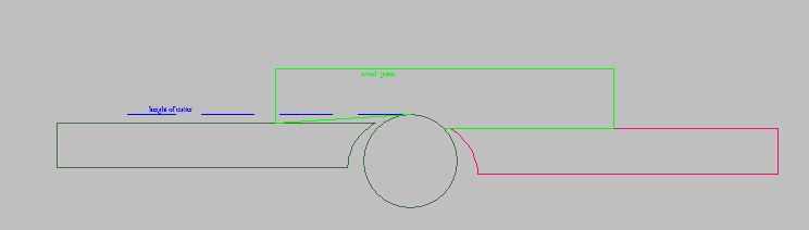

Well with my brain churning on this I decided to go to my trusty CAD and draw this out , but because  I don't have animation (it was another $grand$ to get animation) I can't  get it to move through the process but with a couple of still pics maybe I can say it:
This below pic is the configuration where the  out feed table and  the TDC of the cutterblock are in the same plane
ning-jointertablerwithtdcsetting-5193-95Please observe that  if everything proceeds as the  above picture shows that there is not a  snowball's  chance  in that hot place below of a taper being generated.
But for the picture below I have exaggerated the  proudness of the cutterblock  to show what is happening when it stands proud.  And how much this odd cut path  produces this effect is all a factor of how proud the  cutter block is of the out feed  table.
ning-jointerwithcutterproud-5193-42.jpgWith the Cutter block standing proud the work has to tip  by whatever small amount in order to make contact with the out feed table.  Granted the operator is holding the piece on the in feed table  which will prevent this tipping  - - right up till the work has progresses far enough that the operator brings that  down pressure  to the piece on the out feed side.  And then the tapering begins.
So I have concluded that jointers DO NOT cut tapers.  Not unless the cutterblock is a little proud of the outfeed they don't.
