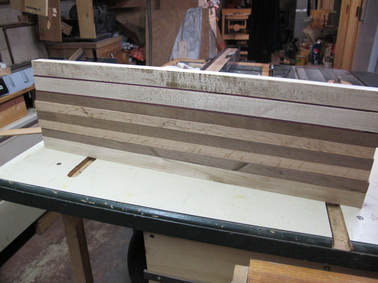

The stock-

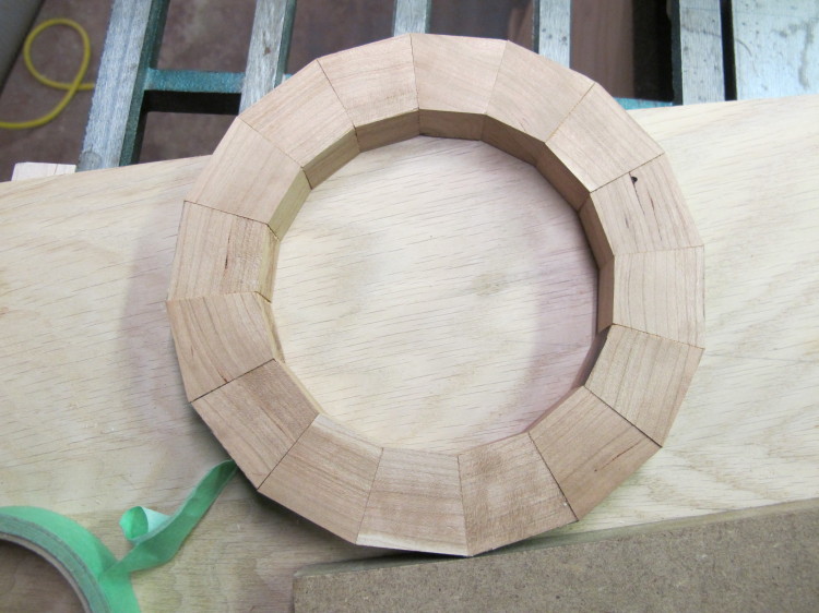

First ring-
ning-img-3015-5098-91.jpg?width=750
I was really encouraged by how well the pieces fit after making some tweaks on the angled fence of the jig. These are just held with masking tape.

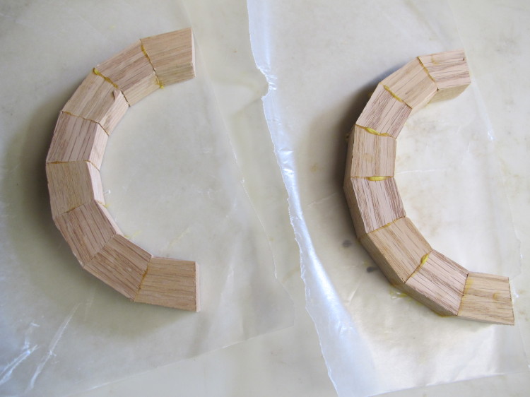

Just to be on the safe side, I decided to glue the rings in two stages- two halves then glue the two halves together.
ning-img-3024-5098-12.jpg?width=750

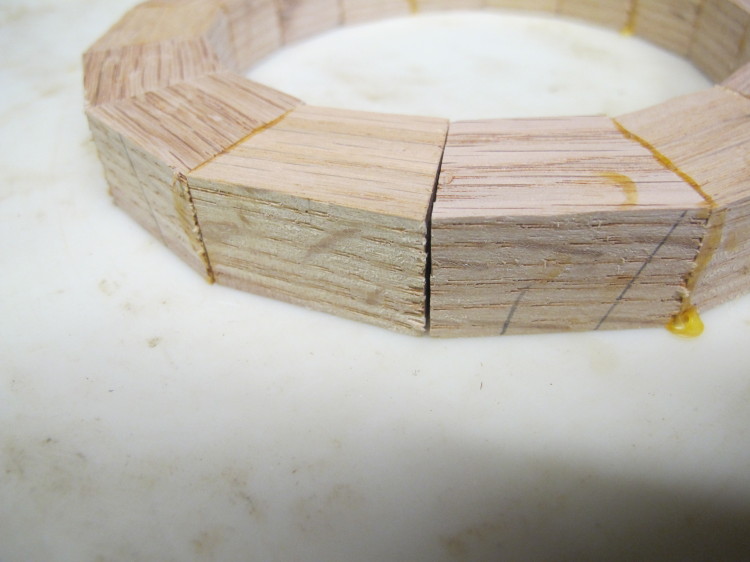

It was lucky for me that I took this route because when I set the two completed halves together all was not perfect in the Land of Oz
ning-img-3029-5098-18.jpg?width=750

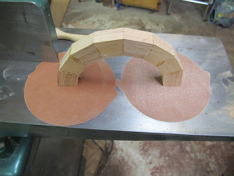

Close but No Cigar as the Carney once said. The very slight error, that didn't show with the tape clamp, now was obvious. The "fix" for this is pretty simple. A flat surface and some PSA sand paper.

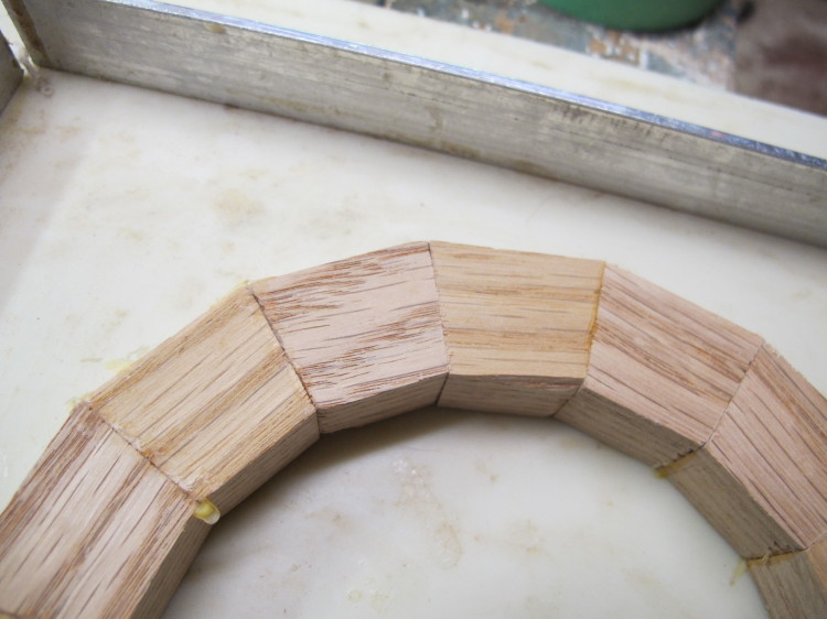

ning-img-3033-5098-92.jpg?width=750
A few passes and the two ends are brought into alignment. Both halves need sanded.

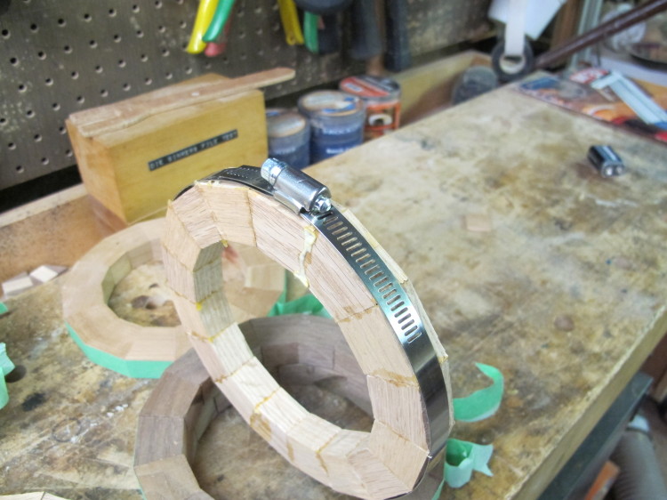

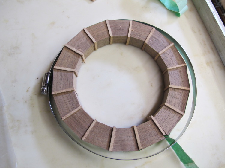

Finally, glue and clamp the two halves
ning-img-3036-5098-4.jpg?width=750

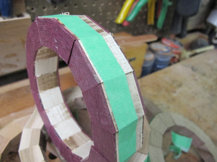

This ring used up my last piece of Purple Heart-
ning-img-3028-5098-47.jpg?width=750
