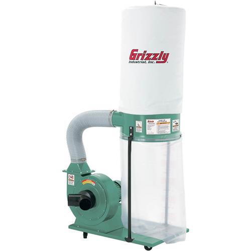

I've got this one and love it. Had it for 9 years, using the original fabric bags, no complaints!
