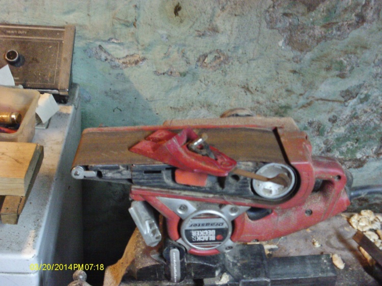

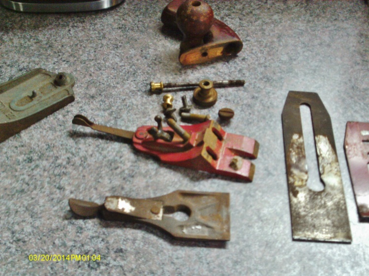

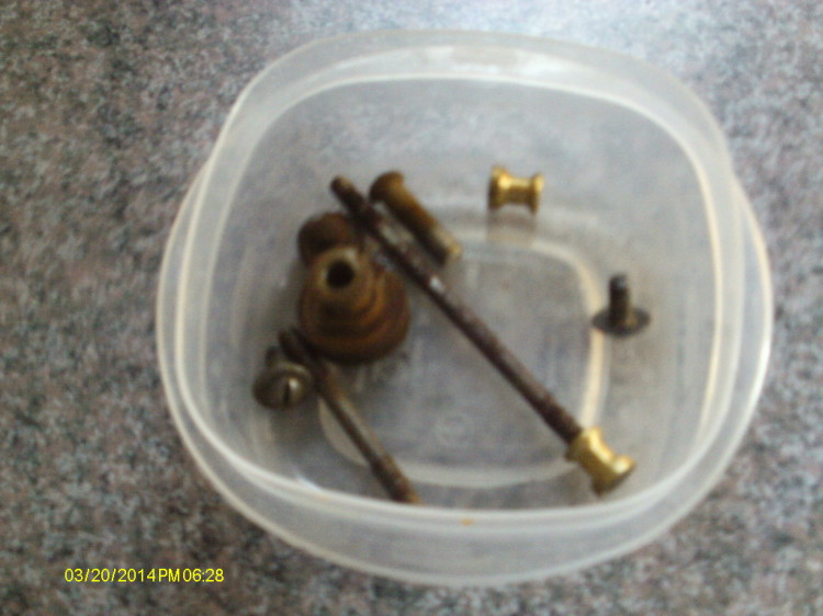

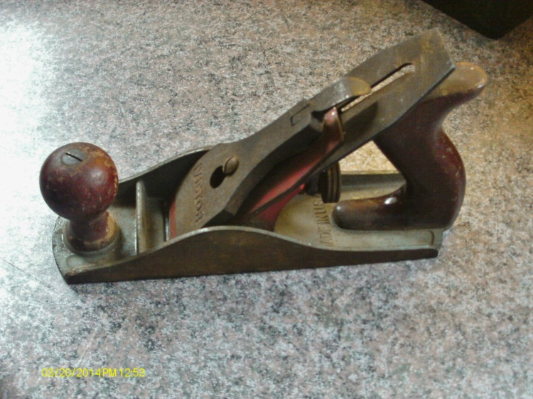

 A box came in the mail today, all the way from Florida.   Hidden under a MOUNTAIN of shredded paperning-imag0015-4012-87.jpg?width=750Supposed to be gray body, red chipbreaker and frog.   This is a Victor #1104, made by Stanley.   Looks like it needs a bit of rehab.   So, first things first.    Tear it all apart.ning-imag0022-4012-28.jpg?width=750And get rid of a few spider nests that came along for the ride ( got enough of them, already)   Placed all the small items in a plastic tub/bowl.ning-imag0026-4012-20.jpg?width=750Pretty, ain't they?    I tend to use a bowl for these small items, otherwise, they WILL wander off, and not return.   Had some shopping to do, so things had to wait a bit ( GRRRR!) But, sandpaper bought, wrong size sanding belt bought (seems to happen to me alot) can of RED Rustoleum bought, and a tire for the van.  The Other half was along, so things took awhile.    Got back home, and hauled all the goodies, and parts to the Dungeon Rehab Center.....er, shop.    Down there, we have numerous machines to torture any who show up.   Like a beltsanderning-imag0015-4012-47.jpg?width=750Known to make the nastiest rust ( and wayward fingernail) quake in fear . A  used 100 grit belt.   It works at removing rust from flat areas, flattening backs of irons, soles and sides.  Even gets a frog to shape up.  Face was sanded smooth and flat, and the frog's seat area was sanded as well.   Worked over the base casting, and got a start on the iron.   The chipbreaker's edge was also sanded flatter, then the chipbreaker was given a coat of RED.

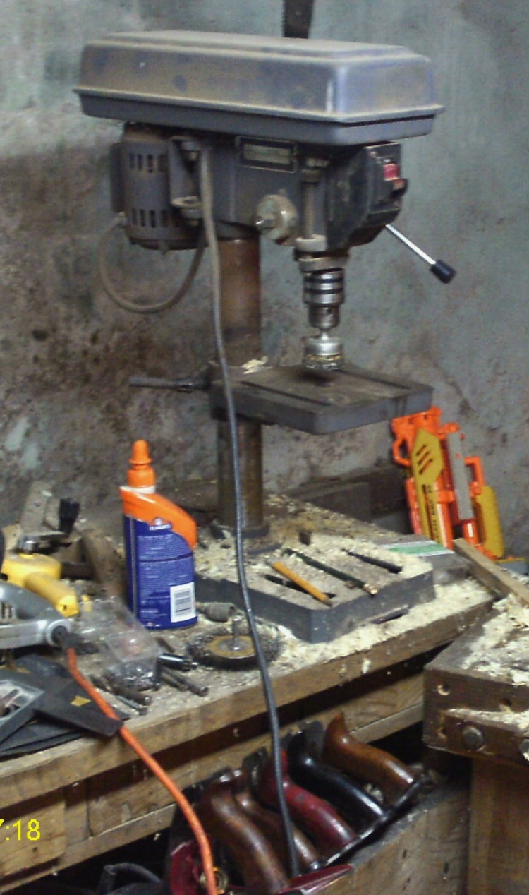

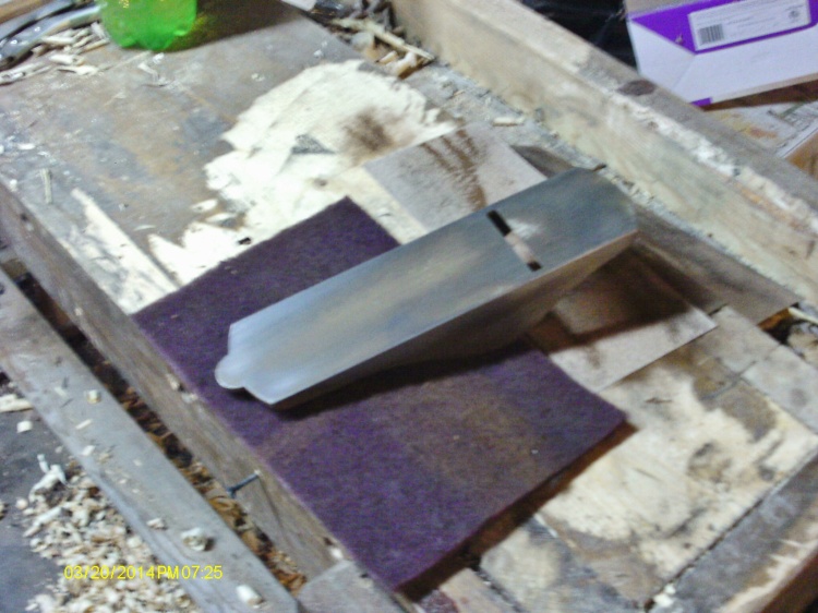

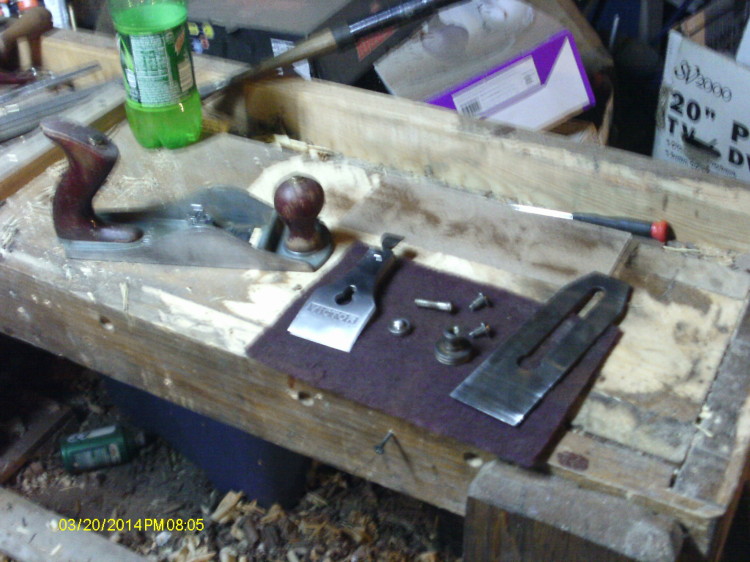

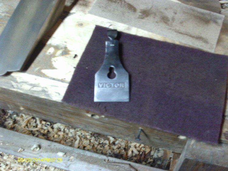

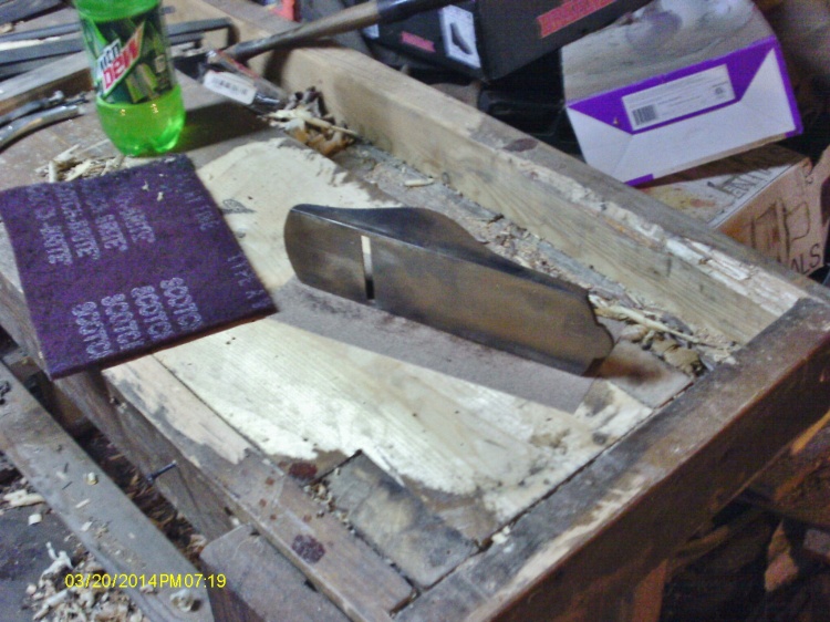

There is another torture device in the  shop, one that can make bolts, and other small items vanish into thin air ( or thick shavings under the bench)ning-imag0017-4012-80.jpg?width=750A H-F  5 speed drill press!!!   Armed with a bevy of wire wheels and brushes.    Unless one has a death grip on a bolt, this machine will send it into the great unknown, at light speed!    Visegrips are strongly encouraged.    Got all the bolts, threads and all cleaned of rustiness.  Set them aside, in that bowl.  Worked over the lever cap, first with the wire wheels, and wire cups.  Then placed it on a purple 3M pad, and scrubbed it clean.ning-imag0021-4012-30.jpg?width=750Still need to mask it for a red  paint job around the letters.  Ok, back to the base casting.  Wire wheels, both on the dp and on a dremel unit.    Got the inside about cleaned out.    The sides and the sole were next.   Had some 100 grit sheets, and a few ( ok, ok, a LOT) of swipes over the sheet, to get the brown stuff off.   Sheet fills up with rust, stop shake it off.   While that is going on, a few trips along the purple Pad to clean things off the casting.ning-imag0019-4012-50.jpg?width=750The sides, and thening-imag0020-4012-64.jpg?width=750sole.   Getting worn out, so, time to close shop for today.    Been up and about since yesterday MORNING, and a 12 hour workday too.   So, had everthing sitting on the benchtop, ready for tomorrow's work on itning-imag0022-4012-37.jpg?width=750Haven't decided on the handles, just yet.  They aren't all that bad, not perfect, but not too bad.  Maybe later tomorrow, I can get a shaving out of this old plane.
